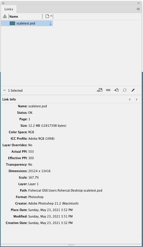

When I resize it to 4800 x 3200 the effective ppi drops to 180 and it says that it has scaled to 166.7%, but it's still smaller than it's original size of 12000 x 8000.
To get a 300ppi matching Effective resolution, you would have to upsample the scale in Photoshop—you can’t upsample an image in InDesign. Upsampling doesn’t typically get you any visible quality change in print, but if you sampled up to 503, the Effective res in InDesign would be 300ppi:
