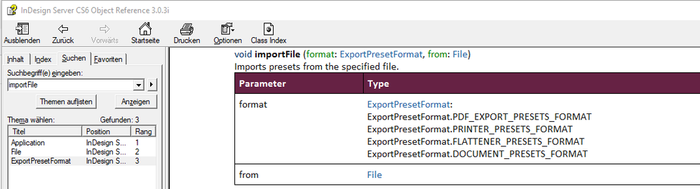

Hi Peter,
I have no InDesign Server at hand, but according to DOM documentation for InDesign Server CS6, see the chm files at:
http://www.jongware.com/idjshelp.html
this line should work:
app.importFile( ExportPresetFormat.PDF_EXPORT_PRESETS_FORMAT , pdfExportPresetFile );
Provided of course that the preset file, a valid *.joboptions file, exists.
From the InDesign Server CS6 chm file DOM documentation:
Tested this with my desktop version of InDesign 2021 and it's working very well.
