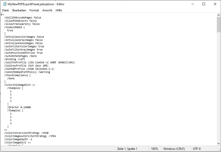

Jun 30, 2021 Jun 30, 2021
Hi Peter,
I have no InDesign Server at hand, but according to DOM documentation for InDesign Server CS6, see the chm files at:
http://www.jongware.com/idjshelp.html
this line should work:
app.importFile( ExportPresetFormat.PDF_EXPORT_PRESETS_FORMAT , pdfExportPresetFile );
Provided of course that the preset file, a valid *.joboptions file, exists.
From the InDesign Server CS6 chm file DOM documentation:
Tested this with my desktop version of InDesign 2021 and it's working very well.
Duplicated a joboptions file to my desktop, renamed it and successfully imported it to InDesign with:
$.writeln( app.pdfExportPresets.everyItem().getElements().length );
// 54
var presetFile = File( "~/Desktop/MyNewPDFExportPreset.joboptions" );
if( presetFile.exists )
	app.importFile
		presetFile
// 55
Result with my German InDesign 2021:
Uwe Laubender
( ACP )
