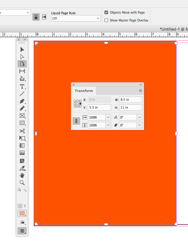

When you use the Page tool (rather than Document Setup) the relative position of the page size change should respond to the Transform panel’s Reference Point setting when the Liquid Page Rule is set to Off:

After you transform the page via the Page tool with Liquid Page Rule set to Off, you can open Document Setup and update the document to the new size.
