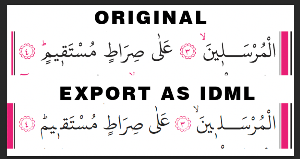

I’m using the English version of InDesign 2025 on macOS Sequoia 15.4. I recently switched to the ME (Middle Eastern) version because I’m working on an Arabic document. However, I’m still unable to export the file to PDF—the app crashes every time I try.
I also tried saving the file as an IDML, but the text got messed up: the colors changed, and random spacing appeared between letters. I’m attaching a screenshot to show what happened.

I tried. In the new texts I write, it adds spaces like the ones in the screenshot I sent.

I think I might have an answer. InDesign has recently switched its complex-script text rendering engine to HarfBuzz, and many older fonts seem to fail to render correctly. We've seen questions here about older fonts for languages like Urdu, Gujarati, or Nepali, failing with symptoms a lot like yours. So I think you can safely ignore my longer message about document corruption and IDML, and just try these two things:
1) Can you tell us the name of the font in question? Is it one I can download and test myself?
and
2) You should try turning on the Legacy Character Shaping Engine in the Preferences under Advanced Type to see if your Arabic compositon problems go away.

I’m not completely sure, but I think the font was custom-made for the person.
2) You should try turning on the Legacy Character Shaping Engine in the Preferences under Advanced Type to see if your Arabic compositon problems go away.I tried it, and the spaces disappeared. I think I’ll need to rework all the old projects.
Thank you for your attention and responses.
Well, in that case there's little chance that either HarfBuzz would be updated to work with this font, or that this font would be updated to work with HarfBuzz. I imagine that you could just leave the legacy shaping engine on whenever you were working on this project; I don't expect that Adobe will yank it from InDesign anytime soon.
After switching to the legacy shaping engine, did the diacritics go back to their magenta color, or are they still black?

After switching to the legacy shaping engine, did the diacritics go back to their magenta color, or are they still black?Everything is in its place. The diacritics magenta

Edit: I still think that all of this stuff is valid but I don't think it actually will help you. Please refer to my message above regarding the legacy text shaping engine - that is, in fact, the thing that changed in the 2025 version that I suspect is causing this.
so I’m guessing something changed in the 2025 version that’s causing this.
