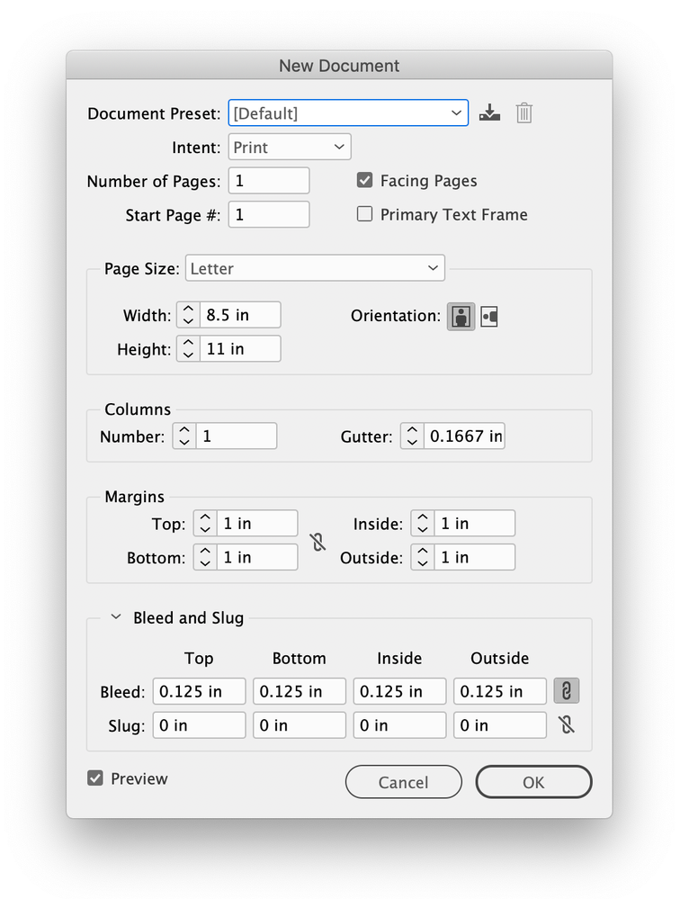

Hoping someone know how to fix this! Something is wonky with my blank document presets in InDesign. Nothing custom, just the normal standard pages (letter, legal, tabloid, etc.) are all slightly larger. For example the preset for a new "print" 8.5 x 11 letter size document looks like this:
If I create this file, the document setup shows the page size as "custom" and also increases the margins from 0.5 to 0.5019 like this:
Any idea how I set these back to normal?

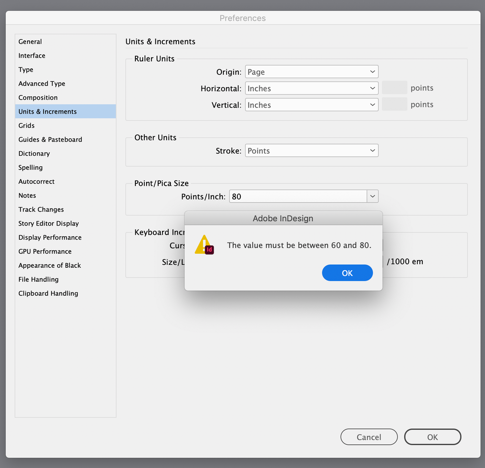

Hi Uwe, It’s not obvious, but Points/Inch can be user defined—any number between 60 and 80:

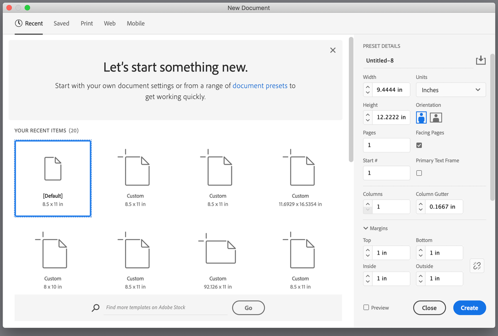

If I set it to 80, I get this for Letter:
But with the Use Legacy New Document Dialog set in General Prefs I get this:

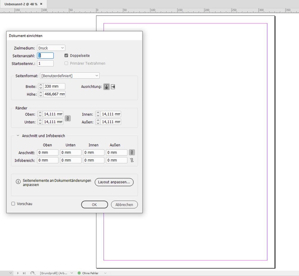

Confirmed. Just tested with InDesign 17.2.1.105 on Windows 10.
The (new) New Document dialog does not stop to amaze me.
Even if you go to to the Print tab and choose any of the fixed page sizes like Legal or Tabloid or even A4 or A3, you'll get the wrong format in e.g. Inches or Millimeters.
All formats are affected!
Point/Pica Size set to 80:
The fixed A3 paper size in the (new) New Document dialog is showing as 330 x 466.667 mm. Which is rather odd. Should be 297 x 420 mm. Note: At first glance I misread the 4 in 466,667 as 1, because the number is cut at the left edge of the input field.
The result is indeed 330 x 466.667 for A3 as we can see from the File > Document Setup dialog:
FWIW:
The legacy New Document dialog is still working as expected.

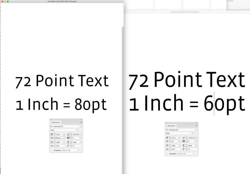

I’m not sure it’s a bug, I think the Point/Inch preference is there because traditionally no one agreed on what the exact dimensions of a point was. Most of us are now assuming it is exactly 1/72", but the preference is there, and is dangerous if it gets randomly set to something else because it has a direct affect on text size and leading:
So I’m wondering if the wrong page dimensions are an alert that the preference is not set to 72?

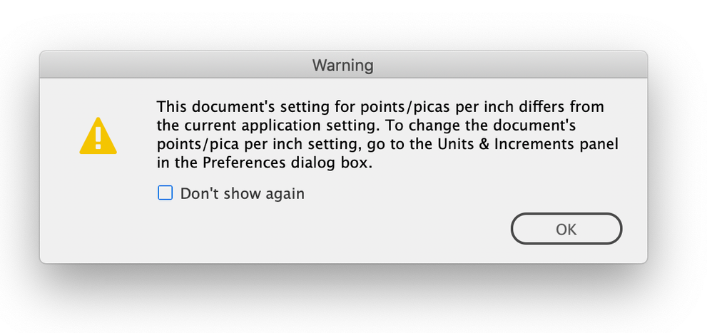

Also I do get a warning if I  open a doc that has a point size setting which conflicts with the current application setting.
