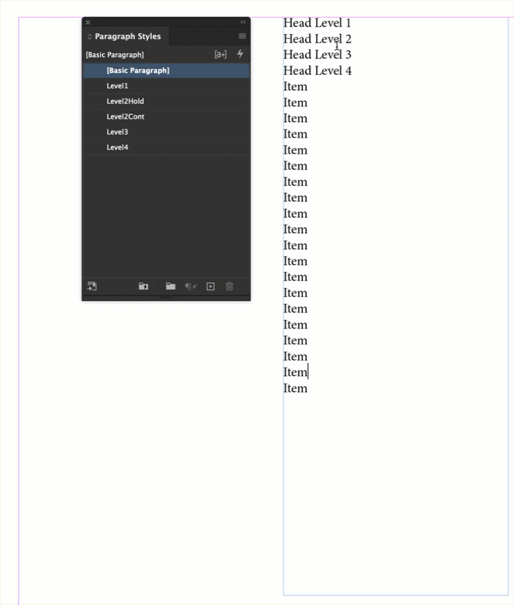

This is how I would do it but keep in mind that InDesign can't automatically count by 100s so you will need to set those Level 1s manually. Everthing else will auto-increment as you edit.
If this looks right, I'm happy to share the file.
~Barb

🥳  I thought my brain was going to explode, but we got there! 🤯
There were two things about your numbering that was unusual: counting by 100's and holding the counter value. Plus InDesign has so many clicks to edit the numbering I couldn't remember what I was doing when I finally got there.
I'm going to share my file but here are the screen shots first. It sounds like you understand numbering pretty well, so I'm just going to say that all paragraph styles have the same list name. Look closely at the levels: there are seven styles, but I used six levels (sequentially, 1, 2, 1, 3, 4, 5, 6) and its unusual referencing of the levels (always ^1 for the top level (never ^2), then the normal appended levels, i.e. ^1.^3 for heading level 3).
Disregard what I said about InDesign not recognizing the style number override—it does. So for 200 and 300, I didn't make a new style, I Alt+Opt clicked on the numbering icon on the Control panel and set it manually. Everything fell into place with each override.
I'll be back with a link to the file next. You are welcome to ask follow-up questions.
~Barb
