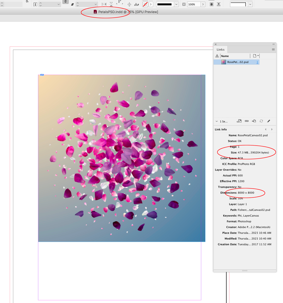

it would have an effect.
As long as you are not embedding the links, the file size of the link doesn’t have any meaningful affect on the InDesign file size. Here’s an example of a placed, flattened, 47MB .PSD, and the same file downsampled, saved as a 631KB .JPG and placed:
The InDesign file sizes are the same because in both cases the preview proxies are nearly identical:

quote
By @rob day
I meant in case of speed when placing - not finall size of the INDD file as in this you are 100% correct - but if InDesign had to generate preview from  50MB file and 50kb file - and do it 1000 times - there would be a difference in how long it take.
