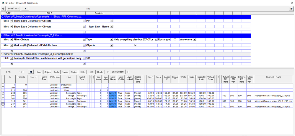

quote
Hopefully I'll find one in time!
By @FalconArt
Done - Before:
After:
Temporary inconvenience - resampled images are saved as PSD...
Not free - but I'm pretty sure well worth it.
Just 3x simple Tasks and any number of linked images can be processed.
Of course only selected links can be processed and finall resolution can be set as desired.
Explorer ,
May 15, 2024 May 15, 2024
This is it! @Robert at ID-Tasker completed this function with his ID-Tasker Tool. I am now able to separate instances of a single file and resample them to 300 PPI—with ease!
