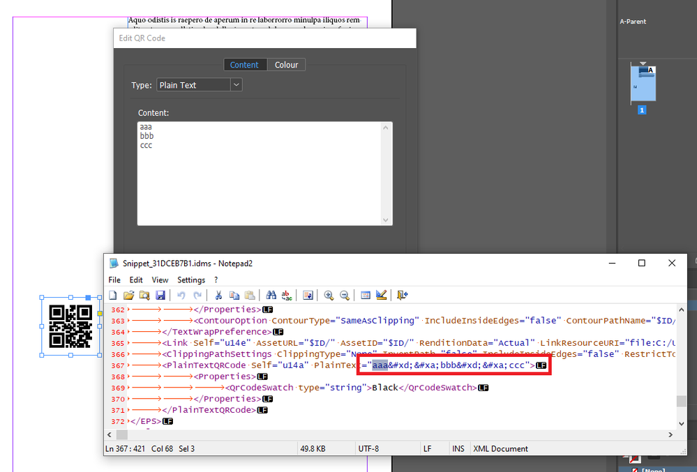

LEGEND ,
Feb 25, 2025 Feb 25, 2025
@James Gifford—NitroPress
You mean this?
Typed as - "aaa"+Enter+"bbb"+Shift&Enter+"ccc"
But it looks like the second one - forced/soft / Shift+Enter - has been converted to hard anyway?
Exposing the actual code in the code, as it were, instead of "interpreting" it into a readable display. You have that for the ID side, but it would be preferable to read it back from actual codes for that last lick of accurate representation. I dislike processes that mask key elements, even if in the name of convenience.
