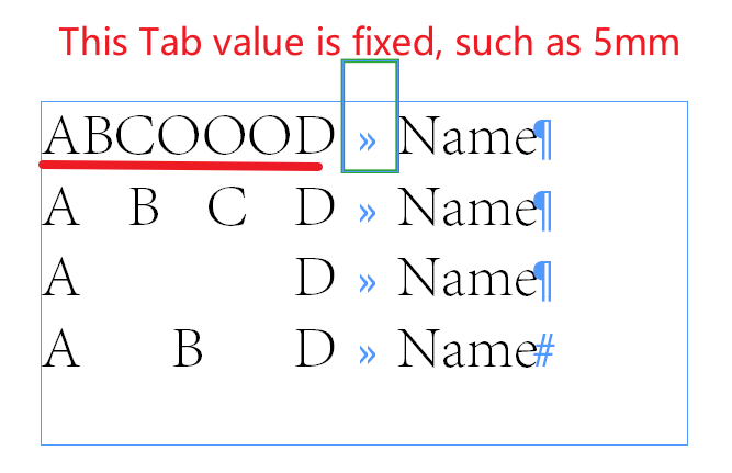

I need to align the three above.
Some people may use grids, but that feature is difficult to use and I usually don't use it. It's better to use font spacing.
However, it is troublesome to adjust the font spacing. For example, when the font size becomes larger, I have to try every Letter spacing value.
Just want to ask: What is the relationship between font size and spacing, can we calculate it?

Hi @dublove5CFE, the issue here is converting tracking units (which I assume you are using to space out the A in the second line) into ruler units. Tracking is measured in em units which relate to the font size. The conversion factor is, 1000 / font size. Some fonts have differing sized em squares but Indesign seems to calibrate them all to 1000 units in terms of the UI and scripting API. You can see how it works in this script, that attempts to solve your problem.
* Letterspace Chars To Align Tab.
* Script expects to have a text selection that includes paragraphs share a tab stop,
* and will adjust tracking of characters before the tab character so that the last
* characters in each paragraph align.
* So that the script can be run multiple times, it resets tracking to 0 each time.

Hi @dublove5CFE, I have written a modified version that also sets the tab stop so that the tab character width is 5mm (you can adjust this in the script). I've also put the letterspacing into a function so it can be used for other purposes.
Try this version and see what you think.
- Mark

Yes, that's it. You're amazing.
Thank you.
Your script may be included by Adobe in the future and comes with it

Forget it, I'll manually modify the tab value.
This space looks so strange.
I want to keep the tab, just make sure that the spacing between the tabs is exactly one word wide
Copy link to clipboard
Copied
Okay, no worries. I'm sure I can make the script do what you want, but I don't understand what you mean. Sorry.
- Mark
Copied
I'm sorry to trouble you too much.
I want to keep using tab, just make the value of tab exactly one character wide.
(Full width character width)
This way, I don't need to try adjusting this value multiple times.
Copied
I'll repeat myself - what are you trying to achieve OVERALL?
What kind of publication are you preparing?
How do you get your data? How is it originally formatted?
Can you show us more real life example screenshot?
