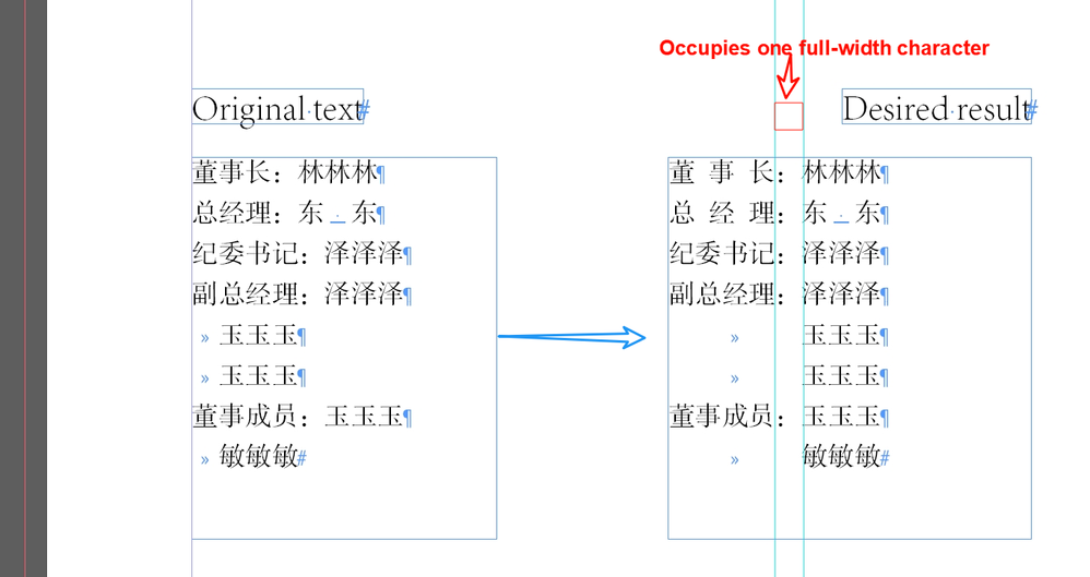

ABCD Name
AD Name
ABD Name
I need to align the three above.
Some people may use grids, but that feature is difficult to use and I usually don't use it. It's better to use font spacing.
However, it is troublesome to adjust the font spacing. For example, when the font size becomes larger, I have to try every Letter spacing value.
Just want to ask: What is the relationship between font size and spacing, can we calculate it?

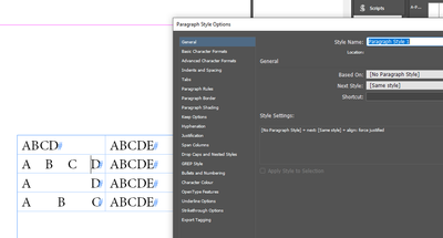

And @Peter Spier has been right from the beginning with his table suggestion ...
In this case script would be much simpler - convert text to table and then set width of the column(s) and insets of the cells ...

Explorer ,
Jun 16, 2023 Jun 16, 2023
just
I explained in detail that I want the spacing to automatically be the width of one character (full or half width)
Sorry, it's a bit messy~ I replied incorrectly to another person.
Should add a version number to the script.
Perhaps this is the most applicable.
How to add the situation of to it, which is a colon (:)
  app.findGrepPreferences.findWhat = '^[^\\t]*\\t';
There are generally two situations:
① Tab separation
② Separate with ':or :', just align the colon here
This width will change
5mm at 12pt font size
But when it comes to size 30, it needs to be adjusted to 8mm.
I hope it is automatic.
I want to keep the tab, always one full width word wide
The gap is always the width of a full width character (or half width character)

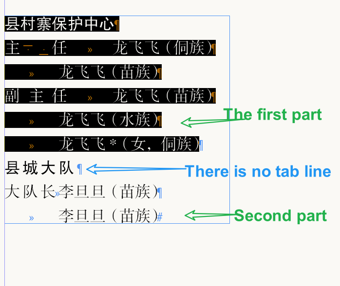

hello@m1b
There are still some minor issues with this script.
Could you please take a look again?
Thank you very much
More important issues:
If you run it for the second time, it may not work. The reason is that it cannot clear the first "tab" setting. Perhaps the script should be initialized before starting to run each time.
2. Cross column, cross page operation, script error.
3. There is an empty line between the selected areas, or there is no "tab" in the line, resulting in an error in the script.
Guide ,
May 20, 2024 May 20, 2024
@m1b
Hello, great M1B,
Thanks, I finally found you.
Help test this.
After running the script above, TAB did not align to the widest position.
There is no alignment before and after, it seems that it is not the width of a character.
It seems that there is a space in front of TAB, or an error occurs without a tab. The running script (two columns together) and cross -page (two pages together) will also make an error.
The script sometimes makes an error after repeated operation. It may be that the old TAB value is not cleared before each operation. At the same time, the word distance should be removed before performing the follow -up operation.
In addition, in the process of using it, I found that using TAB as a interval is more convenient, and the space -based interval is not conducive to later modification.
It is hoped that the width of the TAB defaults a full -angle word, but it can be customized and modified, such as 2 full -angle or 1 half -angle character interval.
The full -angle is targeted at Asian text and half -horn for English.
Thank you very much ~
If there is no TAB in the selection, it will not be aligned.
As if:
This situation should skip the line without TAB
I was right when I aligned the first part.
When I aligned the second part, I found that there was no reference object, so I chose the first part together, and the result could not be aligned.

Hi m1b, I an sorry to trouble you again.
I still want this colon(:) to be directly aligned.
: Occupies one word width.
Some customers like to use colons.
When the workload is heavy, using regular still takes up a lot of time.
Thank you very much.
