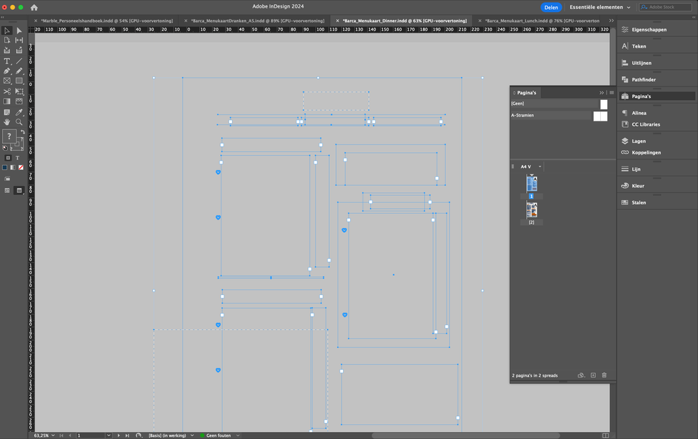

Hi there,
I've been experiencing an issue for quite some time now, and with each update, I hope it gets resolved. It could be something on my end, but this problem always seems to occur unexpectedly, without any changes to my settings.
The issue mainly arises when I return to InDesign after working on something else on my laptop. When I revisit my designs, everything is greyed out, including other open files. Although I can still select individual items, that’s all I can do (I’ve attached a screenshot with everything selected). The only way to fix it is to save, close the file, and reopen it, which is quite frustrating as it disrupts my workflow.
Has anyone else encountered this? Does anyone have a solution?
Thanks so much!

@Caitrina5EBE said: "… The issue mainly arises when I return to InDesign after working on something else on my laptop. When I revisit my designs, everything is greyed out, including other open files. Although I can still select individual items, that’s all I can do (I’ve attached a screenshot with everything selected). The only way to fix it is to save, close the file, and reopen it …"
Hi @Caitrina5EBE ,
I'll repost your screenshot inline so all could see its contents at a glance:
It just looks like there is a spread without a page, but page contents remains.
That could be dangerous. We have seen samples over the years in this forum where this kind of issue lead to serious corruption of the InDesign document. You say: "… The only way to fix it is to save, close the file, and reopen it …"
That's interesting. Because there are others who could restore the page only by exporting the document to IDML and open the IDML file as new document. Or others copied the selected contents, added new spreads and pasted the contents in place.
I'm glad you found a solution that does not harm your contents.
Now for the cause. Can you describe version of InDesign, version of operationg system, system specs of your machine and perhaps, did you note, what other apps are open or how long it was that you did not access InDesign?
FWIW: I never had this issue. Not on macOS, not on Windows. But I see some cases on both operating systems during the last ten years where this happened to InDesign users.

Community Beginner ,
Aug 13, 2024 Aug 13, 2024
Hi Uwe,
Thanks for your reply! This bug does not seem to affect my InDesign files, so I'm not really afraid of my files getting corrupted. I think it's more of an overall bug in InDesign, that only resets itself if I restart InDesign.
I am currently using InDesign version 19.3
My specs are: Macbook pro, 16-inch, 2021, Apple M1 Max, 64 GB, MacOS 14.5 (23F79), Sonoma
I mostly use Photoshop, Indesign, Illustrator and Chrome. Not all simultaneously, but they are often in use. I don't know how long it was inbetween the use of InDesign and the bug, it happens really randomly.
Try to toggle GPU Performance in Preferences.
Also, update to InDesign 19.5 (even though I doubt it makes a difference in your particular case).
Aug 15, 2024 Aug 15, 2024
I turned off GPU performance and that worked! Thank you so much @leo.r . Let's see if it will hold up.
