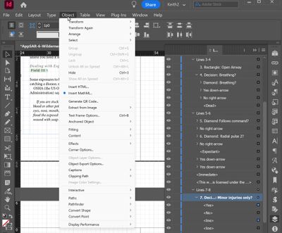

One of the things that occur frequently in flowcharts are lines with an arrowhead and the word "Yes" or "No" attached to them. Of course in my original, each line and word "Yes" or "No" were not grouped together. So, in the picture below, I'm trying to group the word "Yes" and it's line together. I've selected both of them. But, presumably because they're both already in a Group, I can't group them together in a subgroup: the menu item "Group" is grayed out. (Right-clicking won't work either.) I did figure out, eventually, that I can just drag them out of the group to where they're right under the top Layer in the Layers panel and then group them, no need for Dummy Objects.

Yeah, you can't make a group from a thin air - but you can drag ungrouped object into an existing group.
Still, this won't create a sub-group within existing group - but you don't have to ungroup and then group again in order to add a single object.
But yes - you've to drag ungrouped object(s) out of the group, then group them together or with other objects - then drag this new group back into original group.

But it's possible to UNGROUP objects that are grouped and are part of the group - without the need to ugroup everything - or moving this group out of the group and back:

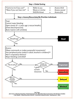

Here's why I was perseverating about this. I will not tell you how long it took me to make this in a way that (a was true to the original, b) pleasing to the eye, c) easy to understand, and d) easy to tweak or adapt for a new or changed triage system. At least that's what I'm telling myself.
Final result:

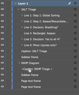

Layers Panel, collapsed:
 Layers Panel, expanded:

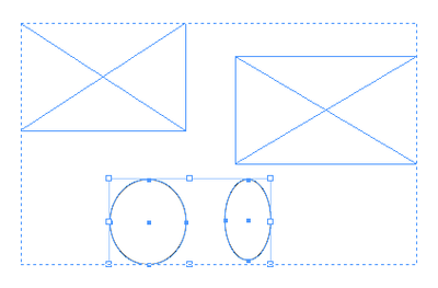

Each diamond is a Groupof two text frames, one to hold the actual text in the diamond, the other to form the diamond.
1. Create a square frame.
2. Give it a one-pixel border
3. Object > Transform > Rotate 45 degrees
4. Object > Transform > Scale > [unlink X and Y scaling] > Scale Y to 50%

But you can do this as a ONE TextFrame:
1) create TextFrame - can be square,
2) type text,
3) use DIRECT SELECTION TOOL to select all PathPoints - you can do an area selection of the whole object,
4) set angle - 45 degree,
5) RESIZE - not scale - the TextFrame any way you want - by dragging any bottom - to make it a diamond.
6) apply ObjectStyle - this step can be made at any point - but not before 1) ;).
This way - it's still a fully functional TextFrame - where only the path defining it's shape is rotated - text / contents remains unaffected.

Well, I tried something like your method, and ran into an unexpected problem. The one thing I didn't do as you suggested was that I did scale, using x=0 and y=50, to get the exact right shape. I don't know, maybe that's the problem but I don't think so.
With my method of two text boxes, I was able to over-fill some of the diamonds, and with the single text frame, even though I tried to over-fill the diamonds (which I need for this flowchart), I was unable to figure out how to do this. See the picture: my original two-text-frame version on the top, the version done sort of like you suggested on the bottom. I tried setting the inset to a negative value but InDesign wouldn't let me. Sigh.

. Yes, with two separate objects - TF for text and Rectangle for shape - you'll have much greater control over the text.
