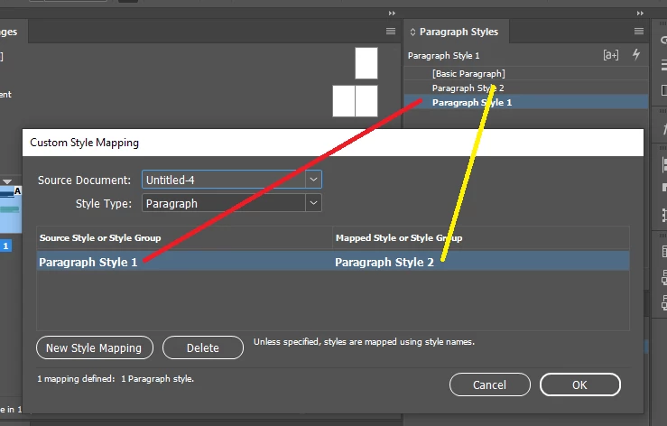

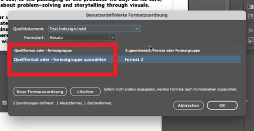

Correct answer Robert at ID-Tasker
@Hari1968
You forgot to select SOURCE style:

Robert at ID-Tasker
Robert at ID-TaskerCorrect answer
March 31, 2025
@Hari1968
Hari1968
Hari1968Author
March 31, 2025
thank you for the help, but i think there must be something eles wrong - maybe a bug ?
lookk here: https://www.loom.com/share/90c89904071148a68754c8f9db0df85a?sid=168609ca-1df3-44c2-b43a-7640fd8641c0
Robert at ID-Tasker
March 31, 2025
@Hari1968
I'll have to test your steps - but when I set mapping from the Links panel - it works.

First frame has stye format 1 / Second frame hast format 2. if I change the text in Frame 1 (format 1) - it also changes the style, of the Frame 2. What I want is, only the contet should change, but not the format.
Robert at ID-Tasker
March 30, 2025
Looks like a bug...
But there is an easy solution - you just need to define Style Mappings for each TextFrame.:
