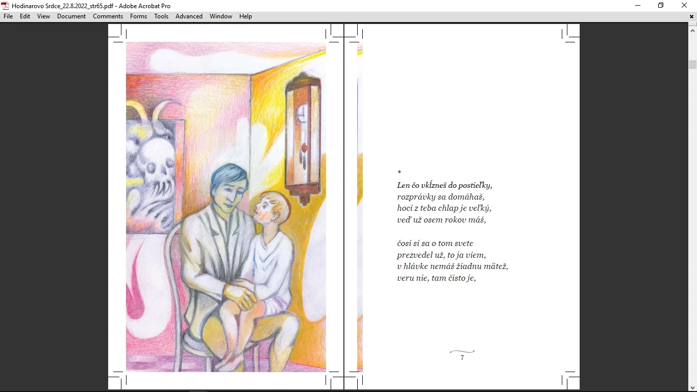

Hi there,
I have a problem exporting a project (poetry book) to PDF with "bleed". It is a combination of text pages and "full-page" pictures (where bleed is needed). At export I set bleeding to 3mm on every side but the PDF is generated like this:
The printer called me that he needs bleeding 3mm on every page and every side. How shall I do that? I have InDesign CS5.
Thank you very much in advance
Correct answer Willi Adelberger
You have to extend the image to the bleed extend on the first place. If you have done so, export with bleed. Obviously your image ends with page edge.

You need to add the bleed allowance in the document setup. If the bleed fields are not showing, click the more options or advanced options button to expand the dialog and enter the bleed amount (3 mm) in the fields. This will add another guide outside the page area to help you locate how far to extend your images.

As @Willi Adelberger said - when designing a document - you need to know if images / background will be touching the edges - and then extend them, so when you send document to the printing company - everything is already in place.
August 22, 2022
Ok, I got it! I have just realized that I actually overlapped the main text frames with picture frames with edges ending right at page borders, so yes, I need to extend them as ID does not take them as main frames and does not allow to bleed over them like it does with main frames. Thank you!
But let me ask - if I let bleed over all sides of the page, from the inner side it bleeds into the neighbouring page and it is probably not needed, right? So I should let bleed on all sides except for inner ones, right?
Willi Adelberger
August 22, 2022
Inside bleed is needed only with wire-O-binding. Normally you can ignore it.
