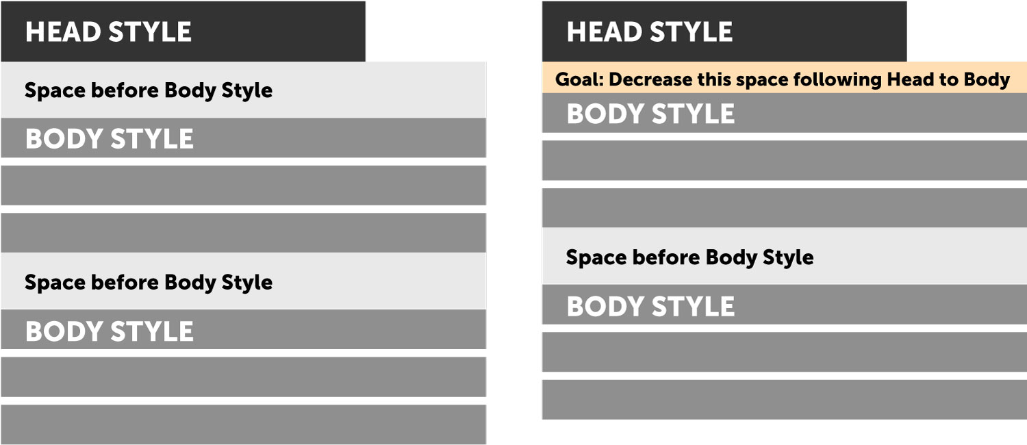

Below is an image of what I'm trying to accomplish. I attempted to make the graphic as simple as possible although I have some more complex instances of this in a fairly complex book layout.
Notes:
  • I know that I can simply create an alternate body style with less space before the paragraph and assign it to the paragraphs that follow the head. But, I'm trying to learn how to do something in a more automatic manner to save lots of time applying styles.
  • I prefer to work with space before rather than space after and would run into the same problem in reverse.
Ideally I could set a "negative" space in the space after panel for the head style, but I don't think this is doable.
Any suggestions?

Apr 04, 2017 Apr 04, 2017
Is this the desired outcome? More space between Body paragraphs but less under the Heads?
Contributor ,
Yes.

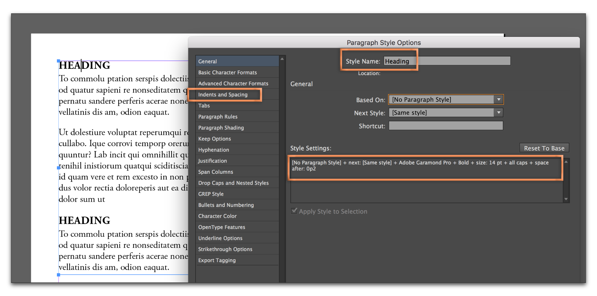

Ok! I set up two paragraph styles—one for the Heading and one for the Body paragraphs.
In the Body paragraph,  I set the space after to 1p0 in Indents and Spacing.
For the Heading paragraph, I set the space after to 0p2 also in Indents and Spacing.
You can, of course, use any numbers that you like.
