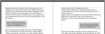

I feel as if I'm missing something simple here, but — is there any way to have a paragraph, in a continuing flow, sit at the outside margin whether it falls on a left or right page? Without assigning different styles, using text boxes, or the like? A limited form of this can be done with the toward/away from spine justification setting, but it affects only justification and not overall paragraph position. I keep thinking of that, and float left/right in web code, but... it seems like there's a way to have a formatted paragraph hug the outer margin, automatically, and retain justification, spacing, rules/border, etc.
Am I missing something?

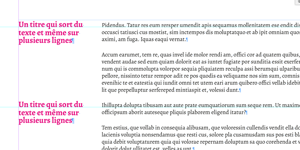

Hi @James Gifford—NitroPress
Do you mean this?

No, more like this:
I'd like these text note/warnings to stick to the outside margin on any page they fall, without using two styles or manually positioning them or such, while remaining part of the text flow. The details (shading etc.) are not the point — I use this general style with shading, top/bottom rules. borders etc. but it always has to be hard-positioned on the page, which is not what I'd like.
Ideally, the formatted paragraph with all attributes should stick to the outside margin as it flows from left to right pages and back.
For some reason, I think this is achievable.... but I may simply be mixing up document techs and platforms in thinking ID can do it.
No, not really interested in scripts or such — I can solve the problem with several kinds of "intervention." But an automated positioning method would be great.

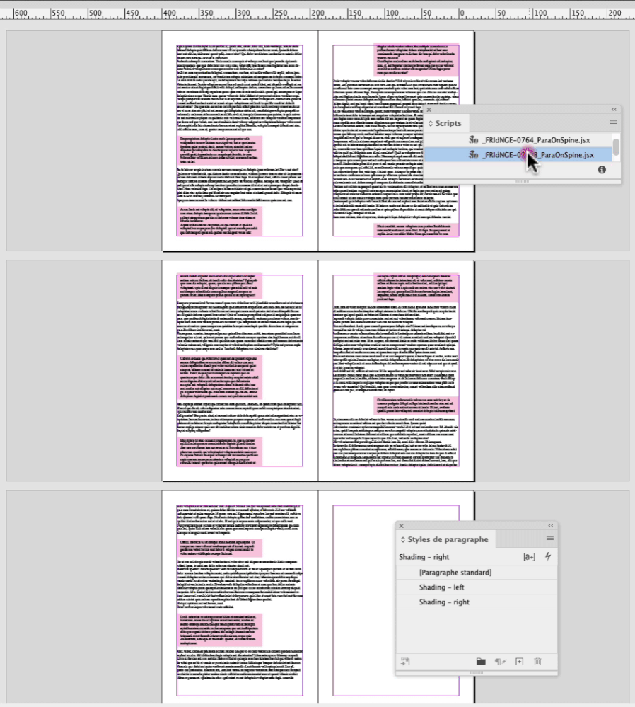

Oct 30, 2024 Oct 30, 2024
Simplistically, as Robert said, 1 click!
    _FRIdNGE-0764_ParaOnSpine.jsx
    Script written by FRIdNGE, Michel Allio [30/10/24]
    GAME WITH 1 CLICK:
    Apply "Shading - left" Para Style on Left Page
    Apply "Shading - right" Para Style on Right Page
    Limitation: No possibility of Para running between 2 pages
    If the Layout moves, Play it again!  ;-)

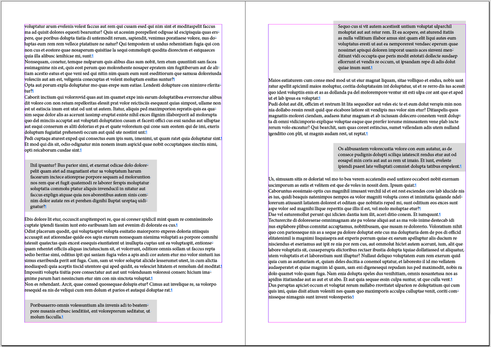

Just For Fun!
[version B, including paras between 2 pages]
First Double-Click: Towards Spine
New Double-Click: Away from Spine
New Double-Click: Towards Spine
and so on! …
