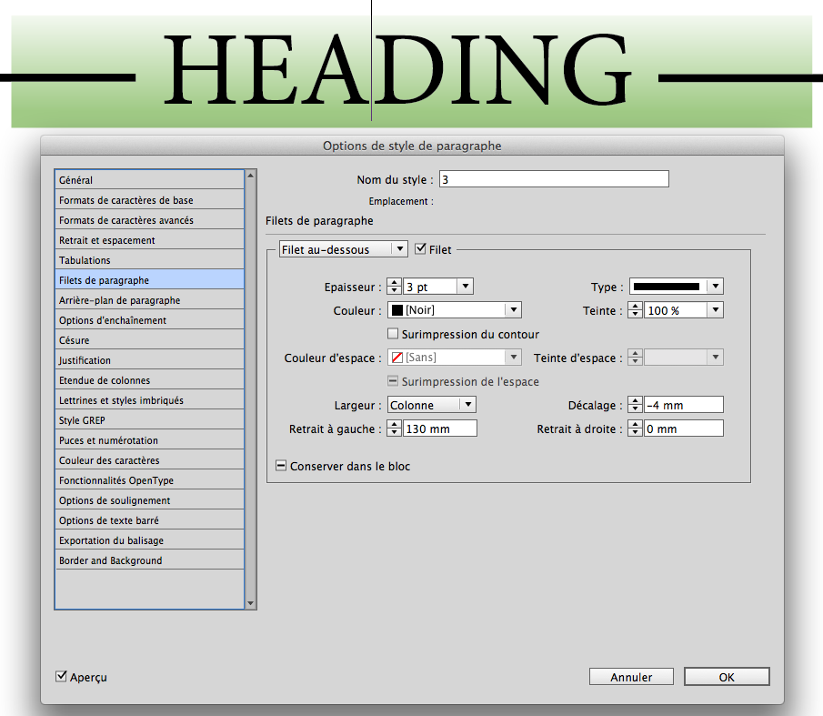

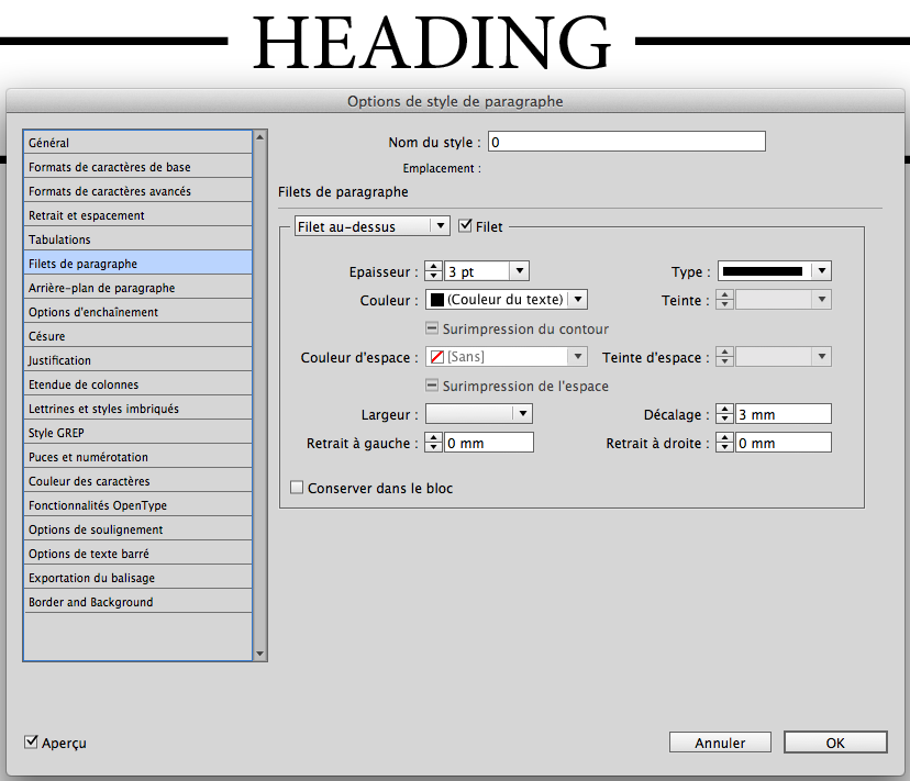

If no background color, 2 para rules [automatic way]:

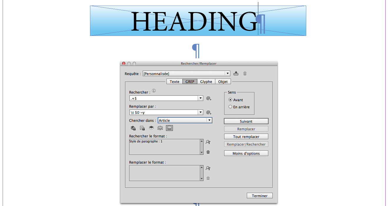

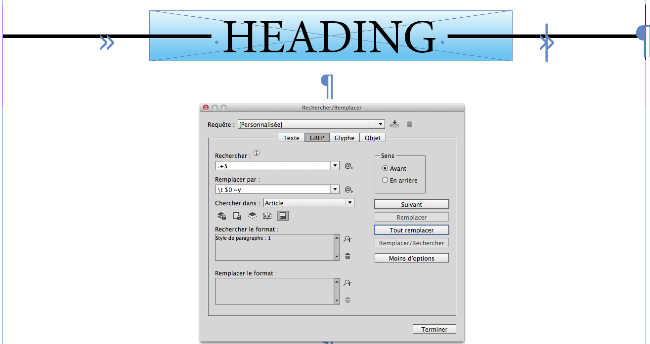

2 grep styles and a simple regex [all replace]:

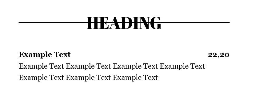

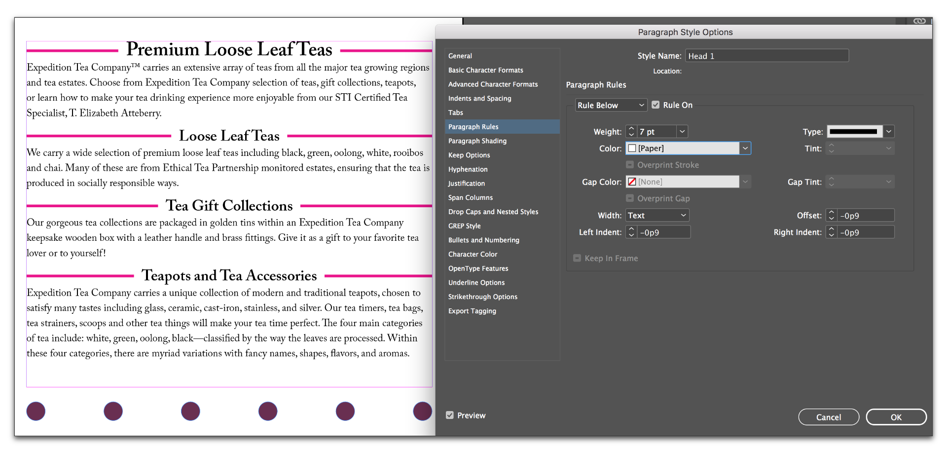

My apologies--to clarify, I'm aware that paragraph shading is an option with paragraph styling; my issue is that I was hoping I could use the shading to (in effect) mask part of the paragraph rule that I've set. I'll attach some visual cues here and to my original question.
My paragraph style looks like this:
which yields this result:

LEGEND ,
May 01, 2017 May 01, 2017

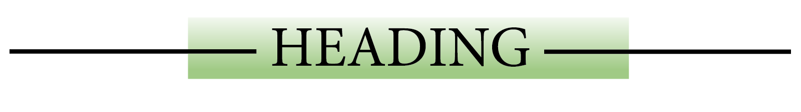

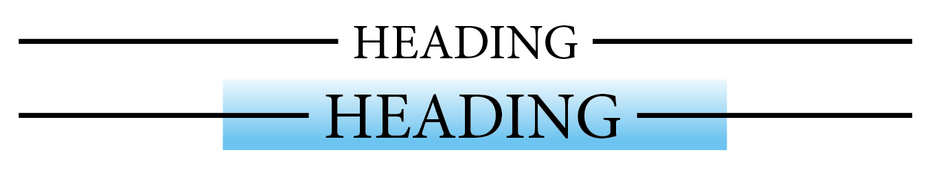

Play it simply with para rules!
Community Beginner ,
This looks great (and exactly what I'm after) could you please explain how you came to it? I'm not familiar with those blue indent notations.
Hi Andrea,
When I have time, I enjoy keystroking Obi-Wan's various solutions to figure out how he works his magic. I love his answer and would not have come up with it myself. If the French dialog boxes throw you off, here are US English dialog boxes, along with my notes.
Add a Rule Above that is the width of the Column, and use the Offset to center it over the text. Mine is pink, but it can be any color.
Then add a Rule Below that is the Width of the Text. Mine is yellow for now so that you can see it. Make it thicker than the rule above, give yourself a left and right indent, and use a negative offset to move it up so that you can no longer see the rule above. Instead of shading as per your original question, this uses the Rule Below to mask the Rule Above.
Then just change the color from yellow to white.
