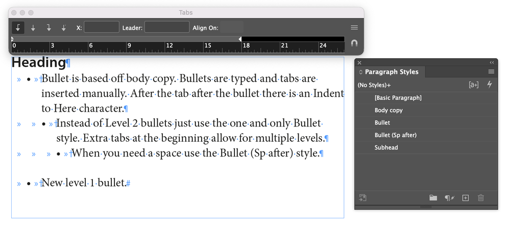

It might be easiest to create a paragraph style for just the space then add that when needed. Give the style no space before or after and make the leading the size you want the space to be. In my example leading is 14 point (as is each successive indent for the bullets). The space is half that. Because it is a style I can globally change it without having to change multiple paragraph styles or adjust every override.
An alternative is to use only one style for all bullets. This will require manually typing the bullets and the tabs, but as there is only one style, style management will be easier and you can have one basic bullet style ans one with space after, as below.
