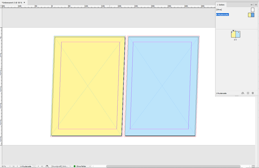

Sample of two skewed master pages:
Applied to the document pages:
If you still see an issue also skew the document pages ( in my sample I skewed by 2° )

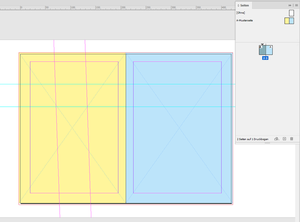

One issue with that solution are the vertical guides from a master:
Not so when the document pages are also skewed to the same degree:
You see, this solution is a bit adventurous…
