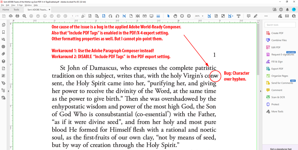

Hi sister Photini,
Willi is right, I think!
You see a well known bug that I already can trace back to InDesign CS6 version 8 that never was fixed.
The cause of the issue is the used paragraph composer: Adobe World-Ready Composer in combination with other formatting properties I cannot really pin-point.
Solution 1 ( preferred 😞
Use the Adobe Paragraph Composer instead.
Solution 2 ( barely acceptable )
Do not use the option "Tagged PDF" in the PDF export setting.
Tested both solutions with your InDesign document:
InDesign 2021 version 16.4.0.55 on Windows 10. Download the test files from my Dropbox account:
https://www.dropbox.com/s/v3mqabm4frpqas1/CharacterOverHyphen-Tests-by-Uwe-Laubender.zip?dl=1
