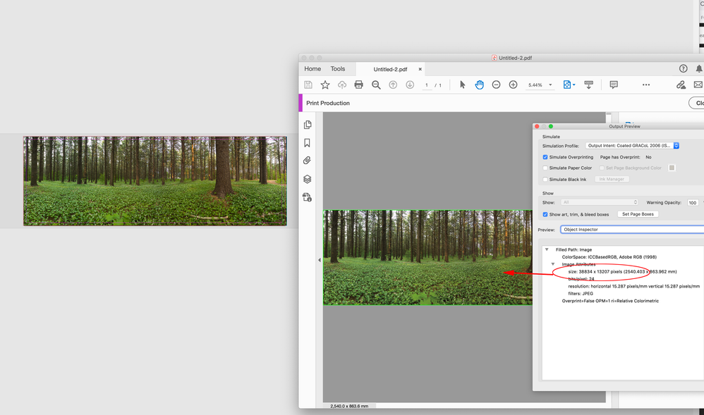

Hi @Ignacio28085554rudj , I was able to get around Photoshop’s 30,000 pixel limit by saving an image as a .PSB, Placing it in InDesign (you might need to drag and drop the .PSB rather than using File>Place), and exporting to PDF with no compression. An Export to PDF/X-4 with AcrobatPro‘s Object Inspector showing my image width at 38,834px:
