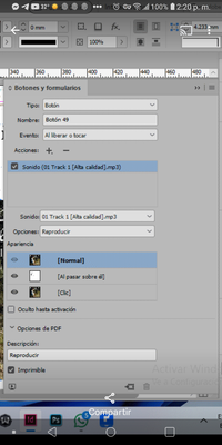

New Here ,
Jul 19, 2024 Jul 19, 2024
Hello and thank you for answer.
I learned how to embebed the .mp3 file inside the document. In panel
Buttons I set all parametters required and in the preview when I do clic on
button the music sounds the problem is tha pdf does not play de audio.
I have InDesign v.15 with PDF 2024
I add screen photo.
New Here ,
@impressive_force00614 is this a statement or question? A little more information?
