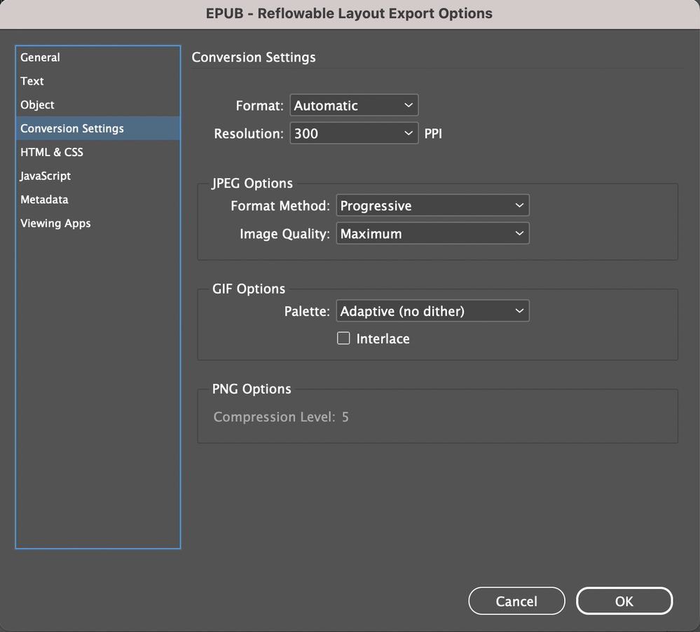

Converstion Setting on Id is in Screenshot 2.

Now export your epub once again with the conversion setting of 72 PPI (actually, the value no longer is applied to this SVG because, you set up an object export override that already tells InDesign to export the SVG as a 72PPI PNG!).
Et Voila! The generated PNG version of your diagram graphic is export at the EXACT required bitmap pixel resolution for the iPad at that screen (document) orientation (landscape or portrait - your choice).

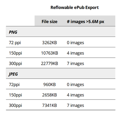

Let's test this, because we need real data to prove whether it matters if we export at 72, 150, or 300 ppi. I created a 5 page iPad Retina reflowable document that contains the following imagery:
  1. a small graphic blown up to fill 2/3 of the first page with two drawn graphic frames with a receded FX look. These frames are rasterized with the Object Export options dialog.
  2. second page: a coloured frame to fill half the page rasterized with the Object Export options, and two copies of the small low res image that is also used on the first page.
  3. third page: a full width Unsplash sourced photo of a dog in a field of Lavender with a resolution of 6048 by 4024 pixels.
  4. fourth page: an SVG diagram taking up the full width, filling the page height ~ 75%.
  5. fifth page: an Illustrator file containing a nice vector illustration. The same file is placed full width to cover a quarter of the page, and placed a second time at a quarter of that size beneath the first one. The lower half of the page I placed a PDF page of a presentation slide that includes vector text and a bitmap image.
I export the reflowabel ePub at 300ppi, 150ppi, and 72ppi. I also made sure to change the Object Export settings for those InDesign drawn objects to mirror those resolutions for each version. Secondly, I set the image file format to PNG and JPG for each version to compare how much the file size would be affected. The first page is set to rasterize as well in the General ePub settings.
The results!
The 72ppi exported version image resolution fits the iPad target to a T. No issues with images breaking through Apple's "speed limit". And all bitmap images (but for the lores image) will be hitting that iPad Retina screen resolution 1:1. And for other platforms these images will more than suffice as well.
The 150ppi version is problematic: 4 images would trigger Apple's error messaging.
The 300ppi version's images almost all break the 5.6 million pixels threshold.
File size grow (as expected) exponentially: the 5 page PNG at 300ppi epub takes the crown at a whopping ~23MB. With a book that contains a hundred pages and many images it would be problematic to publish such a large sized ebook. Users would probably not be amused to download hundreds of megabytes for just a single ebook. If your book exceeds 650MB it will not convert to Kindle, for example (as far as I am aware - I never hit that limit obviously! 😉  )
Not mentioning the download times and reader / device performance: what would your readership prefer? A fast to download, quick to open and smooth reading experience? Or a slow download, long wait time to open your book on their device/reader, and potentially laggy experience on lower hardware?
And not even mentioning having to deal with the potential issues when attempting to upload such an unoptimized ebook to the main publication platforms and dealing with their technical requirements/limitations?
I certainly know what I'd prefer. 😉

However, unless you set the export to use the original graphic, what's embedded is indeed scaled down according to the relative size of the image in the source file and the export resolution. It would take extra work to embed that 6K image file in an EPUB, and generate all the downstream imaging and file management issues.. But then, the consensus of pro/experts here in nearly every discussion about every project and medium is to keep source images at reasonable sizes, and not jam a book file full of billboard-res pictures just because a PDF export will downsample them. Bad practice all around, and with the risk in EPUB of accidentally exporting those monster files into the result.
Second, everything pretty much has to be exported at 150 or 300 ppi to conform to standards, make Apple/Google/Kindle/somebody happy and keep book file sizes reasonable. There's not much reason to go into extended technical analysis and choices based on the sort of care that high quality print needs, or optimal web display, or on the basis that someday we might be reading that file on an ultra-rez tablet.
Size images appropriately going in. Export to the accepted output resolutions. Use ID's fairly extensive image size control options as needed, or some CSS tweaking if that's easier. But everything else — for EPUB — is largely interesting but unnecessary theory. 🙂
Sep 27, 2023 Sep 27, 2023
On thinking about this a bit more, I note two possiblities:
  1. That despite all attention given to the PPI, the exported file is simply too small, in actual pixel width, to carry this detailed content. At a nominal screen density of 144PPI (which is the typical effective resolution of most EPUB readers and apps, regardless of actual screen rez or other factors), make sure this image is at least 144 x [desired screen display width]. At a nominal six inches, this image should be at least ~900 pixels wide.
  2. That because the image is too small, Apple reader is expanding it to fit screen space and thus compounding the blur issue. That is, the effective PPI is 100, 75, or less and the blur thus no suprise.
I'd first make sure the image is exporting to at least 1000 pixels in width, with exact values to be adjusted by the export PPI (150 or 300).
I'd then — as sauggested before — try another, vanilla reader that does not automatically try to expand all images to screen width, which is what I suspect is the real problem here. Without that "feature," your problem would have been a small image, and the solution much more obvious.
Mentor ,
@James Gifford—NitroPressThat's the point I am trying to make: PPI isn't important at all. Just work with an iPad export target in mind, set the epub export to 72ppi, and match your images with 72ppi or higher effective in InDesign. InDesign will automatically take care of that image resolution that works best for that platform as long as you feed it sufficiently high resolution imagery and ensure vector graphics are rasterized at 72ppi using the object export options.
To be absolutely clear: images should be placed full-width in the InDesign document. And your decision to use a portrait or landscape orientation has a direct impact on the final generated image resolution of course. But since most readers (devices as well as actual people) prefer to read in a portrait mode, it is (arguably) best to choose portrait and reduce the max rez somewhat. That is choice you have to decide on for yourself. It depends on the type of book and its content.
Resolution of the images will be just fine (too high actually) for lower specced platforms, but that really doesn't matter, because: the epub will work just fine even on lower specced readers and devices, and converting to other platforms using your epub those online services and other conversion tools will resample those too high rez images anyway if required.
No need to think too deeply about it. But I do agree that most images ought to be displayed full width ideally in a reflowable epub. That is indeed a different story.
PPI is absolutely critical if you want to pass some of the publication platforms' quality checks. And you have to get your images to around 144-150ppi at the expected (or at least average) display size for optimized quality. While most EPUB readers are anything but high-rez — I believe, but am not certain that Apple, too, assumes an effective rez of about 144ppi, regardless of how super-Retina the device is — you can't take something 400 pixels wide and display it six inches across without notable blur and res issues.
It's nowhere near as critical, or as fixed, as it is for print or even PDF. But to say "PPI isn't important at all" is to make sweeping assumptions about image scale and conversion that may or may not be true for an amateur or inattentive designer, or on the vast sweep of EPUB readers. Assuming that all images will be sufficiently large in pixel dimension — as any pro might be savvy enough to use, without exception — to give adequate results through the export process is... short sighted. IMVHO.
Mentor ,
I think we actually agree, although we look at PPI for digital platforms from a different perspective.
In my workflow I don't care about PPI. I only work with the highest specced target platform in mind, and the simple reason for that is because I also develop for mobile and web. I take a more responsive flexible approach: as long as the images match the minimum resolution of the highest spec that I require, the rest doesn't matter.
PPI and how it is related to digital screen tech is a source of confusion even to most publication platforms. I see a lot of garbage written about the subject. The problem with PPI is that it must be related to a physical output format to make sense -- and that is impossible with screen technology. The number of variations in screen size and screen resolution is mindboggling high, so it proved to be an exercise in futility for web and mobile developers.
Which is why that industry works with multipliers and the "mobile first/highest specced target approach" workflow.
And it's the same (worse actually, as you also are aware of) for ebook and their readers/devices/platforms. Mobile and web developers have this all figured out for years now. But most ebook authors (and related industry players) still live in the PPI stone age.
(In mobile and web dev we go one step further nowadays and create multiple targeted versions of our imagery: @1x, @ 2x, @ 3, etc. if required. )
That's why I keep stating PPI is useless as a way to decide on your image resolution. Be aware of the highest output resolution that you and the ebook specs require/wish/want, and work with a digital template in InDesign at 72PPI export.
This may read as an contradiction: One the one hand I insist PPI is useles, but on the other hand I work to a strict 72ppi in InDesign. But that's because I know for a fact that InDesign treats that value as a 1 to 1 pixel match for the selected output platform. The fact that InDesign does this per/for digital platform(s) templates is actually NOT helpful and only confuses users in my opinion.
And I happen to target the iPad in portrait mode as the highest spec platform for most of the reflowable work that I do. FXL ePubs I treat as landscape most of the time, but it depends on the source material/content. Kids interactive ebooks almost always require landscape.
Mentor ,
PS I also wholeheartedly agree with you that we should check the individual context for each project. What I said about the workflow above is only an overall approach, and you are correct in saying that we shouldn't make sweeping assumptions anywhere in the process.
If what I wrote comes across that way: that's definitely not the intent.
