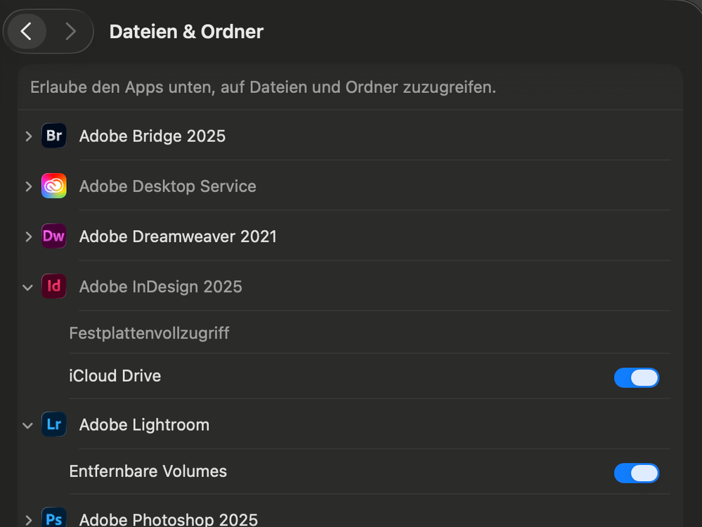

Sep 25, 2025 Sep 25, 2025
Upgdrading to/Installing a new Mac OS has this "habit" of resetting some permissions that are necessary for accessing files stored on any external drive or network server. The first place to check is your System Preferences > Privacy & Security > Full Disk Access. Your Adobe CC apps shoud be listed there; if not, add them all.
If that isn't the issue, there might be a system level incompatibilty between macOS 26 and your Server. Being so new, I suspect there's something in Tahoe.

New Here ,
Sep 29, 2025 Sep 29, 2025
The following is listed under Files & Folders, but I am unable to change it.
InDesign was not included in the list for full hard disk access. I added it myself and granted permission.
However, the error persists.
