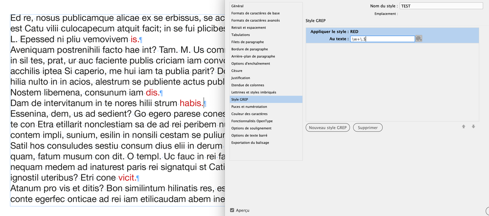

Try this (assuming that there is a final dot at the end of the paragraph):
\w+\.$

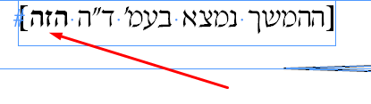

you can see the final bracket is bold and i don't want that just the last word. Being that this text is generated by a script there will never be ANY other chars. Just the last word and the bracket
the text is: (cutted and pasted from ID):
[ההמשך נמצא בעמ' ד"ה הזה]

When I paste your text into a text frame here the GREP works fine to find the last word (but it omits the other words in Hebrew). That said, I have a US English version of InDesign, so I cannot control the story direction or aaply any other middle east controls. To figure this out we need an actual .indd file from you, just a single page with a single text frame with one or two paragraphs, formatted exactly as you are doing in your book.

Ok, here is a demo file. The text is Hebrew. You will the final bracket is bold which the charstyle and that's the whole problem.

Well, this is pretty curious. When I open your sample file here on my US version, everything is fine (I edited the style to make it red for easier identification while testing).
This makes me think there might be a problem in the ME build, in which case no amount of tweaking that GREP expression will make a difference, BUT I'm going to suggest a possible workaround: Add a SECOND GREP Style to your paragraph style for \]$ and use it to apply the [None] character style.
I don't know if it will make any difference, but at least here all of your text shows as US English. Assigning the correct language as part of your Paragraph Style will, if nothing else, enable spell checking, and might have other beneficial effects.

The workaround works perfectly, so for now we will stick with that and detour all the language issues.
