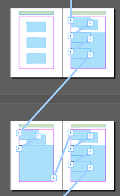

Found something interesting & I'm not quite sure what's causing it -
Basically, I have some pages with two unconnected threaded text boxes.
When I fill one up the text flows normally.
However, when I fill the other up after the first (in this case, big frames first, then small upper frames), all the content of the bigger frames gets pushed and doesn't start again until the content of the other frames ends.
Adding text in the small upper frames seems to add pages that won't connect properly. In this shot, you can see the thread from the last "big box" going straight down, where it connects again many pages later.
Strangely, the content on the first page is fine. (Well, maybe it's not strange, but I don't remember seeing this before... 🙂 ) And the file gets weirder every time I change stuff.
Any ideas what's going on here?
I have some experimenting to do...
thanks!

Additional info... seems like this may be a Smart Text Reflow bug -
If Smart Text Reflow is ON, the existing text in the other (unconnected) frames gets bumped to the end of wherever the newly flowed text ends.
With Smart Text Reflow OFF, the existing text doesn't reflow, but when the boxes are manually linked, no reflow issues appear.

Another thing I noticed: Adding pages (just by adding pages, not by filling with content) doesn't seem to add the threading text icon from the Parent page to the 2nd text frame. Screenshots:
From Parent page:
From Document page:
