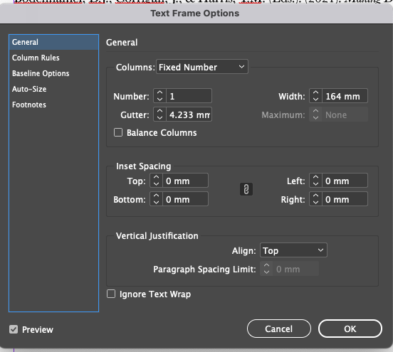

Some things to check: do you have align to grid enabled, What are the Keep Options for the paragraph, what is the Vertical Justification setting for the text frame.

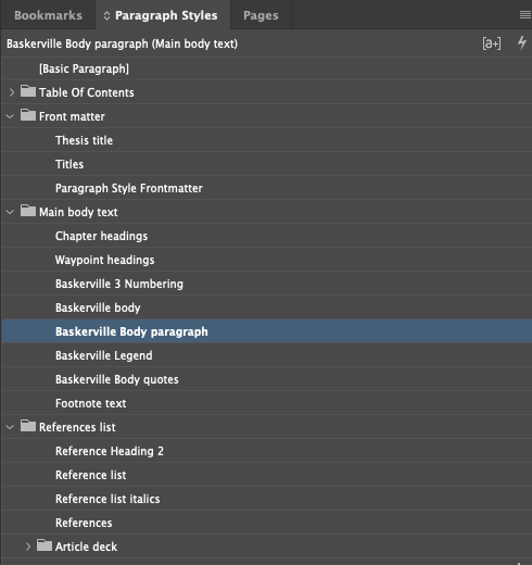

I have it justified with last line aligned left. This is my first project using InDesign so I am learning on the go. Apologies in advance for my lack of knowledge. I have added screenshots of the paragraph setting and the entire page/s samples, as I mentioned it happens quite often throughout the document.

InDesign is all about styles -- Paragraph Styles and Character Styles, primarily, and all text carries a paragraph style by default, Basic Paragraph, unless you change that. Your screen captures are helpful, but they are not showing the style information, so I don't know for sure what's going on. It does look, however, as if you have a very large value assigned for leading (the space between lines) as well as some paragraph spacing (additional space separating paragraphs) which could be included as space before or space after as part of a style, or as space between paragraphs using the same style. At the moment, my best guess for the  gap at the bottom of the page with the single line at the top of the next page is that the paragraph has a Keep With Next  (n) Lines enabled and due to leading and/or paragraph spacing there is not enough room in the frame for the last line and any text from the next paragraph. Your text is not set to align to the grid, and your vertical justification is not set to justified, which would have spread the text evenly to fill the height of the text frame. Vertical Justification is a text frame property, not a text property, and has nothing to do with how your text is aligned horizonatally.
As I said, InDesign is style-driven, and all of these things can, and should, be controlled by properly defining styles for the various types of paragraphs in your document. The bad news is that all of these things can also be set outside the style by selecting text and changing the setting values in the Paragraph, Character, or Control Panels, creating what are called local overrrides or local formatting, and I suspect that's what has happened in your document. I don't mean to insult you here, but your page has some tell-tale signs of someone used to working in Word without using styles -- empty paragraphs to get space between paragraphs being the most obvious. Fixing a file that is built that way is a very time-consuming project.

Good news is I have been using paragraph styles throughout, and have only used the overrides in a few occasions(applying italics to the references). Mostly, though I will redefine the style or create a new style for purpose. I did place from word though, so there is still some formatting (the paragraph space thing) from that which I might not have fixed. Alhtogh I may have used it once or twice to try and fix an orhpan line.  I have tried to get rid of the paragraph spacers as much as I can by adjusting the styles.
Although I probably need more styles to be able to be more flexible with the titles, for example. I have added the info on the two main styles I use on my screenshots. The leading is pretty large (33) because I felt the text felt cramped smaller. It's probably too big on reflection.
"Your text is not set to align to the grid, and your vertical justification is not set to justified, which would have spread the text evenly to fill the height of the text frame. Vertical Justification is a text frame property, not a text property, and has nothing to do with how your text is aligned horizontally."
I admit I haven't completely gotten my head around the object properties of text frames.
I checked the justification and it aligns to the top.
Vertical justification seems to send to text too close to edges, which I assume by also adjusting the inset spacing.
I have not been able to find how to apply changes to text frames that would flow over threaded spreads. Is that possible? Or do I have to adjust them individually?

The remarks about the grid alignment and vertical justification could have been clearer, problably. They were observation that they didn't apply and were not the cause of the problem. Grid alignemnt can be useful, particularly in a long doc to keep lines level across a spread, but I personally find text frames with vertically justified text to be poor form, especially in a facing pages document, so I advocate against making a change from top aligned.
Your Baskerville Body style does indeed have a space between paragraphs with same style of 4 mm set along with Keep with Next 1 line, so I was correct about the cause of that gap. Not sure why you want the keep with next option for body text. I would normally use it with headings to be sure they don't get separated from waht they describe. In body text they can lead to orphaned lines and gaps as you've discovered.
You can create Object Styles for text frames (there is one already built in which you can edit, or create new ones) and new frames will be styled according to which style is set as the default (drag the little "T" icon to the style you want to use in the list). Unlike the [Basic Graphics Frame Style] and setting a default for graphics frame, setting defaults for text frames actuyally works. New graphics frames since day one have been hard coded to have no fill or stroke (object style [None] ) and there's nothing you can do to get around that behavior.
