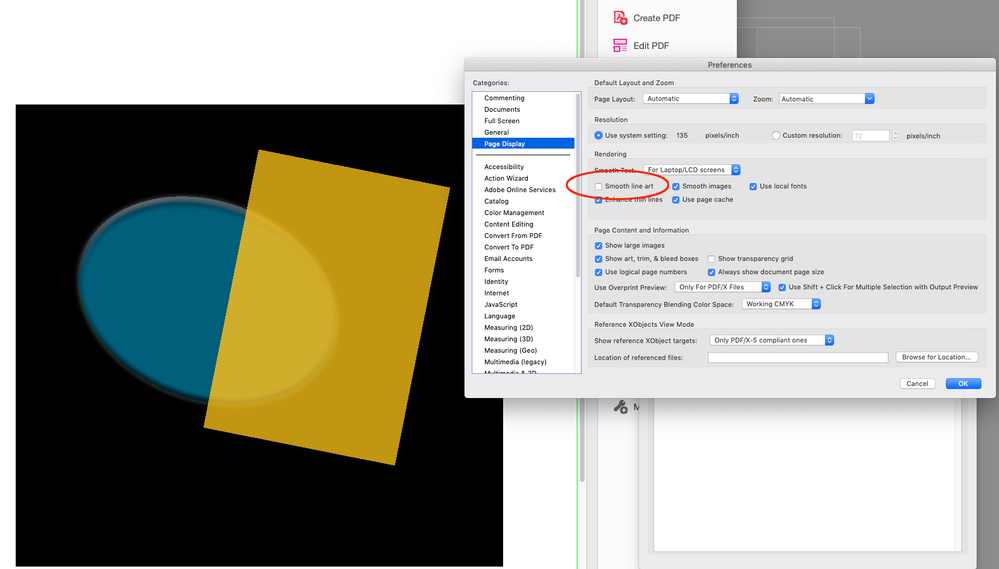

You can force rasters when you export an InDesign page with placed PDFs or vectors as a flattened PDF (Acrobat 4).
Try creating a Flattener preset with a low Raster/Vector Balance (0 will rasterize the entire ID page), something like this:
Add a transparent object anywhere on the spread and export to PDF/X-1a with the custom Flattener preset selected in the Advanced tab:

rob dayCommunity ExpertCorrect answer
July 9, 2021
KL111Author
July 9, 2021
Thank you! Both options work for me!
