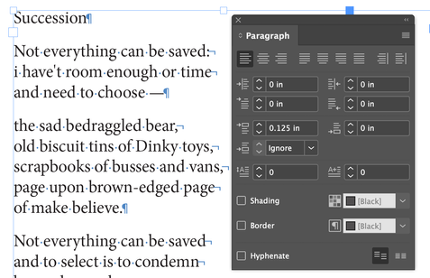

Aug 17, 2022 Aug 17, 2022
Try this:
Instead of using an empty paragraph to add space, use the built-in Space Before or Space After paragraph settings to create the gap. Double returns for spacing is not a recommended method.
Also, use line breaks instead of paragraph returns for the lines that should not have space after them.
This is really the correct answer: don't use soft returns (by any name) in documents meant for EPUB export.
However, there is a specific setting in reflowable export, whether to leave them or strip them (the latter being the standard-based alternative):
Check this, and soft returns will be stripped. Uncheck it, and they will (usually) remain.
But the real solution is to use styles to manage line spacing and paragraphs, not line breaks by any name.

There is simply no way to get this kind of spacing without using spacing above/below on a paragraph style, and at least two styles if you have variations in spacing. I don't know what might have worked in a CS6 document that doesn't now; that spacing hasn't been changed and the culprit is almost always use of soft returns. Oh, and I just noticed the other detail: EPUB always strips multiple returns. Empty paragraphs are deleted. It's possible older export methods somehow preserveed them.
Adjust your styles to use spacing above/below and you should be able to get (or recreate) the layout you're seeking.

To start with, it's universal. Any paragraph you've applied it to will change if you revise the style. In this case, the spacing would be easy to manage. You could also write your own CSS and apply that rule to only that paragraph style making it even simpler to work with the epub output.
This, too, although I was starting with Step 1. You can have one complete layout/style for print, and wholly override that same document by defining each style differently with CSS for EPUB export. You don't have to have two documents nor put up with how the export wants to iunterpret print styles by default.
But you do have to have a "clean" document with an unmodified style applied to each paragraph, with no spot overrides for text formatting.
But I think that's Step 2, here. 🙂
Styles give you full universal control of those paragraphs from a central point. And styles allow you to do many, many different things that content elements (spaces, tabs, extra return) don't, and with finer gradations of control.
You can almost certainly use Find/Change to do most of this conversion for you. For example, find all repeating paragraph marks and replace them with one, and assign a new style to that paragraph. It's all in the order of changes, and how you define the new styles. That is, you do not have to go through manually and remove extra blank paragraphs, and I'd bet one basic style will work for the vast number of verses/stanzas. You can then go through and tag, say, first verses with a different style to allow different spacing control.

  1. It's more work if you don't set up a document using correct methods in the first place, yes. Fixing a poorly structured document is always a lot of work.
  2. It's less work if you use a proper structure and style defintions in the first place, because one change in the style definition changes every paragraph with that style applied, automatically and instantly.

An EPUB is a mini-website with HTML and CSS. When ISOs change their standards, as they have for the web, Adobe has no choice but to write compliant code.
If I want to change the leading throughout the book I'd have to change another paragraph style instead of just one.
No, you don't. What you do instead is base one style on another, with the only change being Space After. When you update the parent style, both change. That's the beauty of styles.
Plus I'd have have to work out what the new spacing worked out at in millimetres.
Your type is measured in points and your spacing should be as well. There are two ways to do this:
  • Change your system of measurement to picas. Spacing will be in points.
  • Keep your measurement system in millimeters as you prefer.
    Type 14pts or 1p3 or 13 pts into the spacing dialog and let InDesign do the conversion to millimeters for you. InDesign will convert measurements as well as add, subtract, multiply, and divide.
