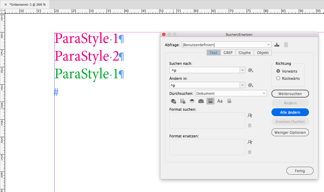

There have been reports that replacing returns in the regular text Find/Change may mess with applied paragraph styles – the return gets "removed", pastring paragraphs temporarily together, and then it gets reinserted in the Change To.
Is that solved in recent InDesigns?

Hi Jongware,
it's not resolved. Did a simple test with CC 2018.
Before find/change:
Result:

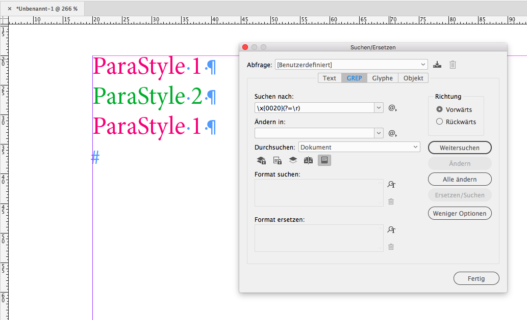

So it's better to do something like that with a GREP find/change using a positive lookahead.
Before:
After:
Uwe
Jan 08, 2018 Jan 08, 2018
Thanks for checking – yes, that is exactly what I meant!
I guess this is just something that cannot be fixed due to how "Find/Change" internally works.
(For those wondering why then that GREP solution is able to do it: it looks at but does not change the hard return, so the paragraphs never get stuck together. Of course the same solution could be transferred to the Plain Text Find/Change, but then it would also use GREP syntax. And we already have that option. Rule of thumb: the regular Find/Change is totally fine for all simple changes, but for more go to GREP.)

FWIW:
My solution is only looking at one single instance of a blank character before the end of a end of paragraph character.
Not very flexible, but exactly the thing Jonathan was asking…
It could be better to expand that to a more universal pattern if you want to catch multiple whitespaces before the end of a paragraph character or the end of a story.

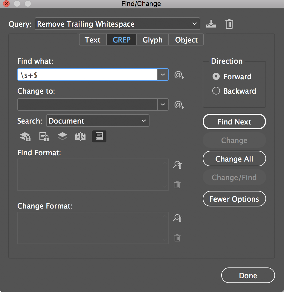

Or use the InDesign-provided GREP query—remove trailing whitespace. Preferable to me because it also picks up multiple spaces at the end, and extra ¶s.
\s+ (any white space, one or more)
$ (at the end of a paragraph)
~Barb
