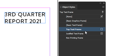

Hello - I've not run into this problem before but for the last few weeks when I create a new layout, the text and images are automatically inserting a sizable frame around the items. The frame doesn't allow anything within the border and is causing a headache with trying to place objects and text close together. How do I get rid of it? And did I accidentally set this to a default? I've been using InDesign for several years and never had this issue.
come up. Thanks for any assistance - photo for reference.

Do you have text wrap settings on that text frame?
I think it may be as easy as:
  1. 14.jpgSelect the text frame with your Arrow/Selection Tool. Then open your Text Wrap panel, which should show some variation of text wrap (that outside border that doesn't let you place anything inside of it. In the example at right, the text frame is set with a regular wrap of 3/16ths of an inch, or .1875 in. If any button is selected in the Text Wrap panel except the one at the far left, the one with the lines goin

@QJessi1974 Yes, that's strange. It has to be some object setting that is interfering with the text box. I can't duplicate it without adding padding. Please let us know your version and OS. Have you tried preference resets and so on yet?

Looks like text inset is set. Can you check Object > Text Frame Options and tell us if an inset is there?
It may have been set as a default by mistake.
You can close all documents, then go to Text Frame Options and set it to zero. That will prevent it from occuring again.
If it's within a document, de-select everthing, then set it to zero and new Text Frames will not have the inset.
  1. 14.jpgSelect the text frame with your Arrow/Selection Tool. Then open your Text Wrap panel, which should show some variation of text wrap (that outside border that doesn't let you place anything inside of it. In the example at right, the text frame is set with a regular wrap of 3/16ths of an inch, or .1875 in. If any button is selected in the Text Wrap panel except the one at the far left, the one with the lines going straight through the box, you have a text wrap set around your text frame. With the text frame selected, click on that far left button and the text wrap will disappear ... on that selected text frame.
  2. Since you're getting that text wrap all the time, you likely have it selected as your tool default for perhaps your Type Tool, likely your Arrow/Selection Tool, and maybe your Rectangle Tool and/or Rectangle Frame Tool as well. To go back to your defaults, choose each tool in your Tools panel, then make sure absolutely nothing is selected. Go to your Text Wrap panel and click the far left button to ensure that the default setting for those tools uses No text wrap.
Do these steps and you should be done with this perplexing little issue. For what it's worth, I know this from personal (unfortunate) experience.

Indeed - the text wrap - this might be set with no documents open - which would mean that it's the same settings for all new documents.
There's plenty of other ideas - from object styles to other suggestions.

Thank you - that worked! I have no idea how it became the default on there but at least I know how to fix it if it happens again. Appreciate all the assistance.

I suspect the same thing.
Text Wrap active? Maybe even in object style?
