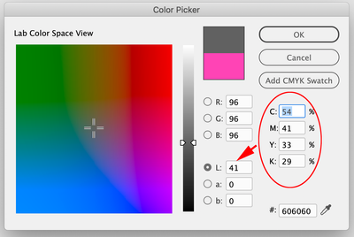

Hi @MAStephens , also the concept of Rich Black only applies when you are trying to get an absolute black on press, and wouldn’t improve a gray because you can get any gray value with a percentage of black. For example these 2 CMYK colors have the same appearance on a Coated GRACoL profiled press. The 54|41|33|29 version doesn’t improve the appearance but could have a cast if the press gray balance is off:

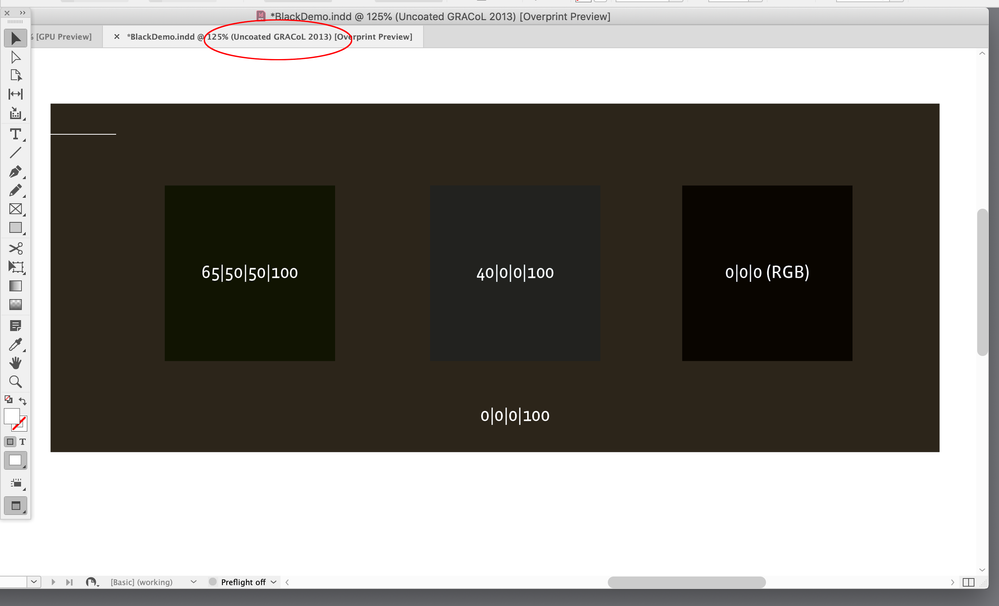

Also, the value and color appearance of 100% black is handled by the document’s assigned CMYK profile—black on an uncoated sheet has a different appearance than black on a coated sheet. Here’s GRACoL Coated vs. GRACoL Uncoated:
