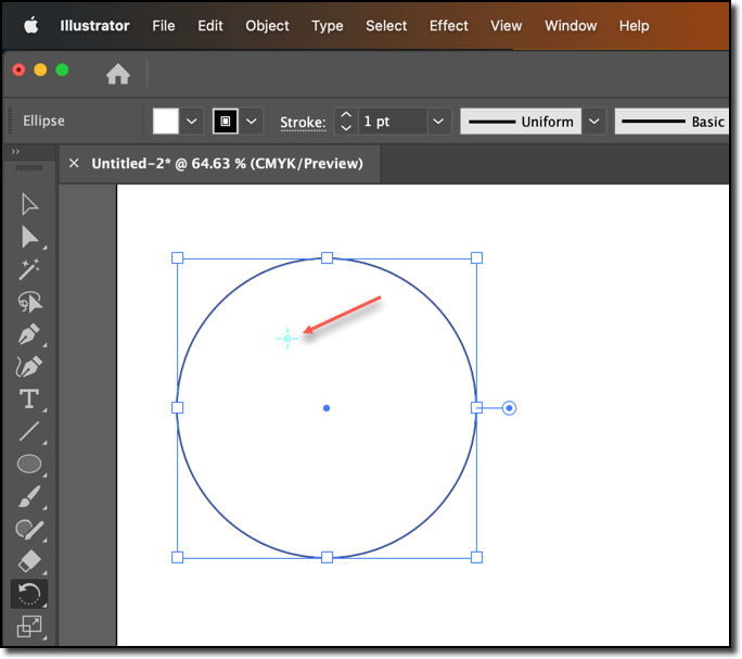

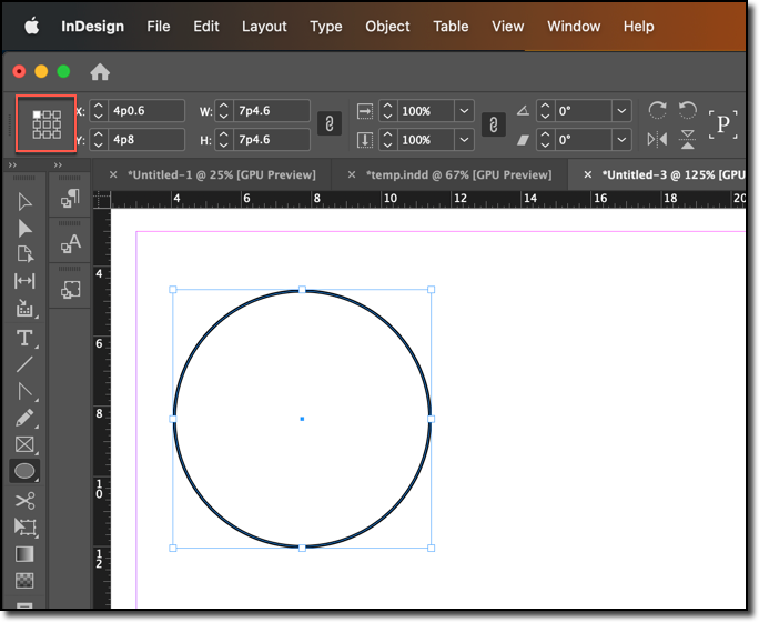

In InDesign, the center of rotation is controlled by the proxy. You set the reference point, and then initiate the rotation.
You said Photoshop was an option, but what about Illustrator? You have a lot more controls in Illustrator, including setting the center of rotation wherever you like by clicking with the Rotate tool.

Rotate an object with the Rotate tool in Illustrator
  1. Select one or more objects.
  2. Select the Rotate tool.
  3. Do any of the following:
    • To rotate the object around its center point, drag in a circular motion anywhere in the document window.
    • To rotate the object around a different reference point, click once anywhere in the document window to reposition the reference point. Then move the pointer away from the reference point and drag in a circular motion.
    • To rotate a copy of the object instead of the object itself, hold down Alt (Windows) or Option (Mac OS) after you start to drag.

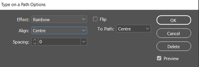

You can click and hold on the Type tool to reveal the type on path tool
Copy your 'satelite'
And type on the path of the orbit
And paste your satelite
You'll now have an anchored object
Object>Type On path
Type On path options
Align Center
Click back into your Path and Select All (to select satelite)
Use the Text Alignment to Center the text
Top right of screenshot
Now you can grab that little blue handle and drag it around the orbit - as free as you like
