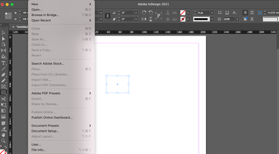

I am facing very strange issue in Indesign 2021(16.2.1) on macOS Big Sur(11.3) where Save and Save As... options is disabled for new document even after adding one path item to the new document. Please see screenshot for the reference
Is it a known bug in this version or am I missing something?
