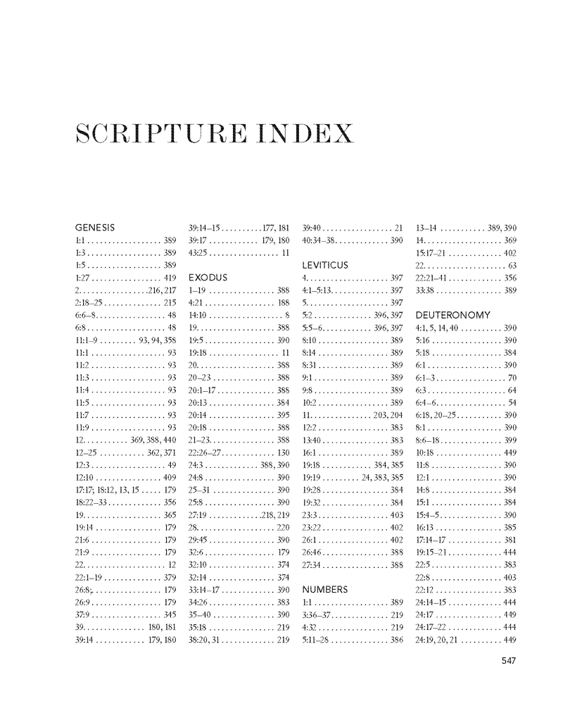

Is anyone aware of a script that will make Bible Verses like this pic in Indesign?547.png

It's just an index. Seems there would be scripts or plug-ins tailored to this specific task.

I make a text anchor with the full bible verse. If only the chapter and verse stand alone it will be impossible. But sorting I do manually. I have the problem, that each translation has a different order. Lutheran translationions have a different than Reformed, and Messianic have another order again. I setup a lot of theological evangelical literature for colleges in Germany, Austria and Switzerland.

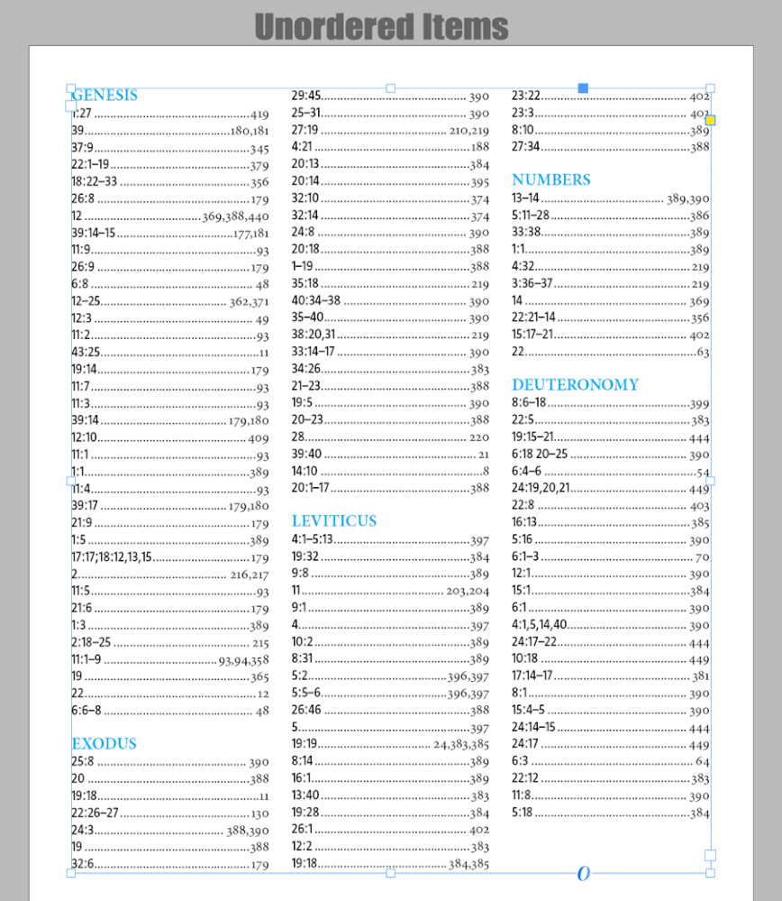

Not sure this is exactly the ordering you're looking for, but SmartSort (free InDesign script) could help you get closer to the desired result, assumed you have a dedicated ¶-style for the head titles. Then
1. Select your Level1 style + “Sub-Sort Only”.
2. Turn on the Sort Numbers option.
Smart Sort TestSmart Sort Test
https://indiscripts.com/category/projects/SmartSort

Thanks for this great information, but I need first make this (Gensis 1:1..........230) in all Book Automatically.
I want Script to make all verses like the pic, and then sort the verses.
