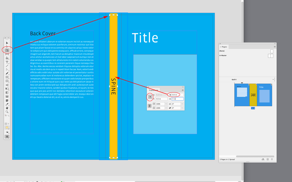

Hi @Fred.L , As Uwe suggests the important part of the setup is to make sure Facing Pages is checked, otherwise when you transform page 2 (the spine), the front and back covers will not align to the new spine dimension:
With the Page tool selected you can transform the spine page without affecting the back and front covers:

and if Facing Pages is indeed checked, AND the spine contents are created as a self-aligning group (using a phantom horizontal element, if needed for an asymmetrical layout), then the steps boil down to:
In my example the spine title and author are simply in a rotated text frame with the Text Frame Options Align set to Center. I’m using a Left Indent and Tab to position the text. The background color is at the bottom of the stack
When I select the Page in the pages panel, and Transform with the Ref Point set to Center, everything stays centered :
The only move i’m making here is changing the W field from 1 in to  .5 in:

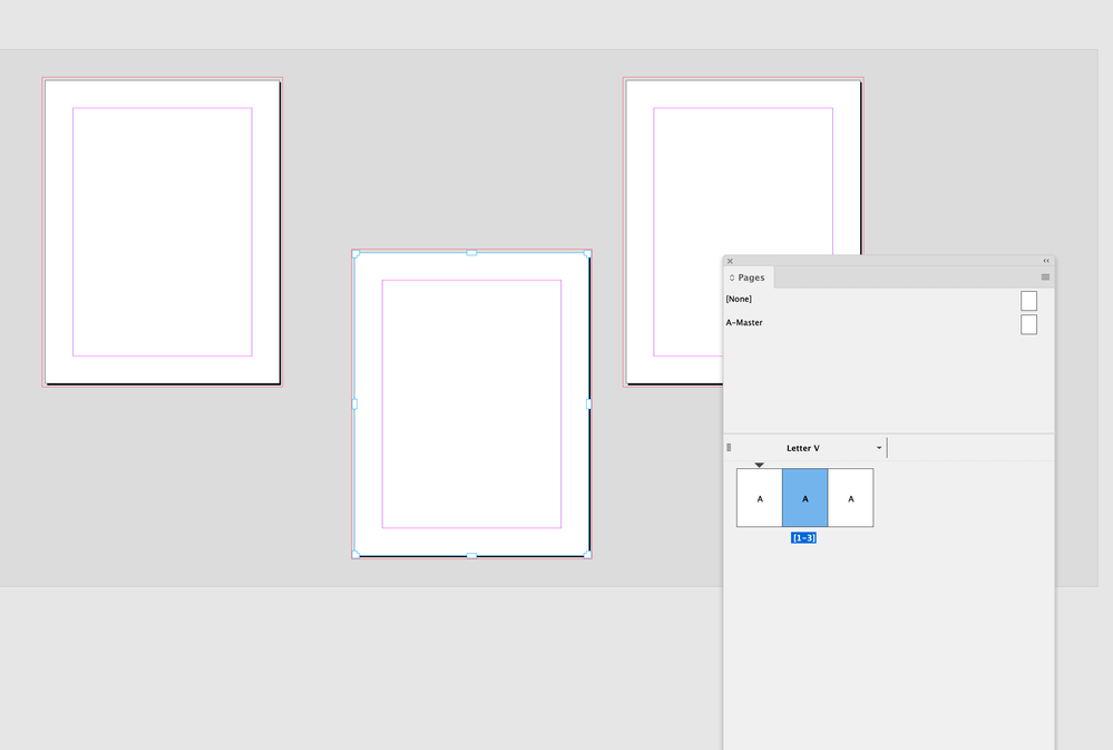

(And if any great mind wants to explain the relevance/connection/machinery/reason for that seemingly disconnected setting... please do. 😛 )
I think the logic is, with a Facing Page document it is assumed the document will be bound—it has a spine, which shows in the Pages panel. With a bound book the spread pages could not be separated—they are always folded at the spine or a gatefold. The spine is indicated in the panel:
But you might be designing something that will not be bound or folded—maybe a window or trade display where there could be space between the "pages". In that case the Pages panel has no spine indicator
