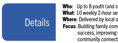

In this text box to the right of this graphic, I want each of the bold words ("Who," etc.) to be right justified with each other (as shown in the second image below), and then the beginning of each description to the lined up with each other. I've played with the various indentation controls, but cannot get it to work. I think I am probably missing some basic function here. Right now, all this text is part of a single text box. Advice?

Hi @DavidacrossAmerica:
You'll need to set a right-align tab stop and a hanging indent. Start by adding a tab before and after the bold words, then set as follows:
  • Shift+drag the the lower white triangle in the Tab ruler (Type > Tabs) to set the hanging indent. (The top triangle remains at the left margin.)
  • Add a right-align tab to set the position of the colon.
  • Adjust either to control the spacing.

Thanks much. But I don't understand how the bold words are right aligned.
Apr 26, 2025 Apr 26, 2025
Through tabs.

When I drag the bottom tab arrow as you describe, the whole paragraph does not move as it does on your example. Can you determine from this screenshot what I am doing wrong?

Never mind, I got it working though I swear I didn't do anything differently when it finally started working.
You did not add a tab. And you want to leave the First Line Indent alone (the top triangle).
In my video, I selected (highlighted) all of the text prior to Shift-dragging the bottom triangle.
In your video, you only had your cursor clicked in the first paragraph. That's why only the first paragraph moved.
When you're trying to format multiple paragraphs, you need to select them.
~Barb
