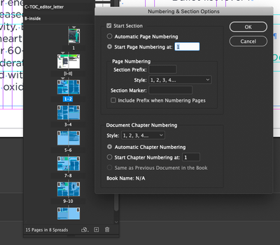

no problem. i will explain.
look at the pages panel i have below, see the triangle icon on top some pages? ( page 2 and 4):
for page 2, if i double click on the triabgle and i get a dialog, i created a section and i set it up to count in roman numbers:
than, i created another section and that one is numbers:
so, look in your pages panel, and see where you have those markers. lets start there.

Jun 11, 2020 Jun 11, 2020
Dbl click page 2 again (2nd screen shot) and disable Start new section. Then double-click the hyphen btwn pages 2-3 in the Pages panel and check Allow Selected Spread to Shuffle in the Pages panel menu.
