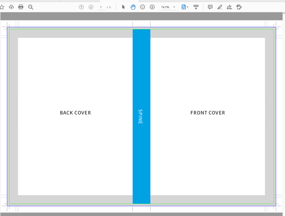

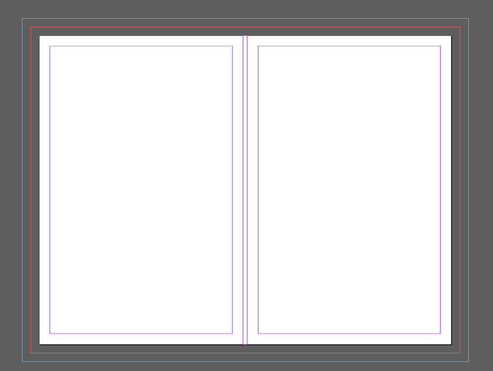

Hi everyone,
I have this issue where if I have a cover spread set up in InDesign as 3 facing pages...the crop marks for the spine always get exported shorter than the crop marks on the outside. You can see they sit off of the trim more than the outer crop marks. I'm not manually placing these crop marks--they are being set in the export settings of the PDF. I can't figure it out for the life of me. I've attached some screenshots. Any help would be appreciated!ex2.PNGex1.PNG

I think I can help.
The lines at the saddle/spine are not cutlines; they're folding lines. If you want cuts there, you'll have to either run them as single pages or manually draw them in.

Hi Randy,
Thanks for the reply! Right, I get that they're folding lines...I just dont see why they are getting exported at a different size/distance than the other marks. It doesn't make sense to me that when InDesign places the marks on the spine--they come out shorter than the outisde marks.

Feb 17, 2020 Feb 17, 2020
Hmm yeah that makes sense...you'd think they would just not export anything there though in that case. They show up because a person checks "Crop Marks" on the export settings. I think they should either be the same size as the other marks or not show up at all. The fact that it does, actually makes it more of a pain for me. The printer I use, actually prefers marks on the spine and they want them the same size/distance from the trim as the corner crops. I think it would make more sense to have them be exported at the same size/distance as the corner marks than the way they do now. If you're printing cover spreads--you would know not to trim the spine. Thanks for the replies!

You are setting what I assume is the wrap area as the bleed (18mm, .7"), but the printer won’t be trimmig off the wrap area. I think you need to build the wrap area into the page and include a more typical .125" bleed. The 2nd example I posted does that CoverWithWrap.indd:

Also FWIW the OP is not including a page for the spine, but is placing a gap between the two pages. The marks at the spine are really cut marks (because of the gap). Fold marks have to be added to a document manually and the convention is a dotted line.
