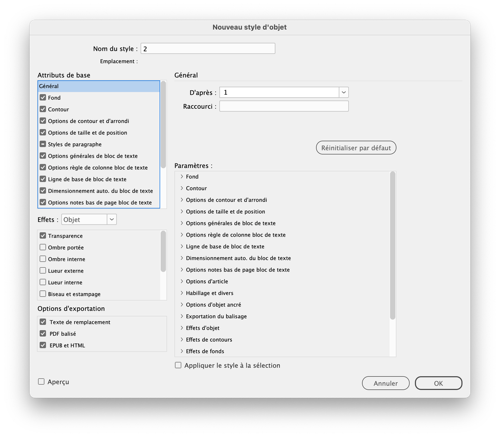

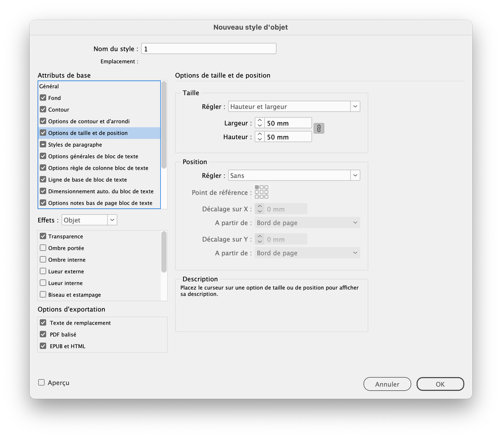

The point is I did not change the size between object style 1 (50 mm, blue fill) and object style 2 (50 mm, yellow fill)
Capture d’écran 2024-12-08 à 18.46.59.pngCapture d’écran 2024-12-08 à 18.47.06.pngCapture d’écran 2024-12-08 à 18.47.24.pngCapture d’écran 2024-12-08 à 18.49.11.pngCapture d’écran 2024-12-08 à 18.49.20.png
If I add a stroke to object style 1, this stroke is also applied to object style 2, as expected. If I change the tint value of the blue fill color of object style 1, it also changes the tint value of the yellow fill of object style 2. So, why the dimensions changes in the object style 1 are not replicated in the object style 2 since this values have not been overriden in object style 2. Try it…

@jmlevy
Yes, I've tried just before I've posted my reply.
As I've said - looks like size & position - isn't automaticaly inheritable by the child - you have to untick it first, before applying to the object.
Size & position is one of the properties extremely specific to the object - so looks like coders treated it that way - unique to the object.
