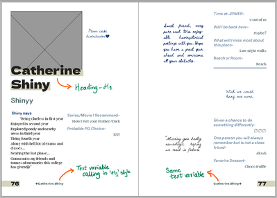

I had to call in the same style for both TOC and text variable because the style refers to the main heading on any particular page. The text variables anf TOC are well in order with pages with a single heading (as seen below)
However I have a few pages where I have to include two headings on the same page (as below). So on such pages I have tried to format the separate headings as a duplicate style of H1 (say h2) which looks the same. But the actual H1 is a hidden textbox containing both the h2 words joined by an '&'. H1 textbox had to be invisible because making a new hidden layer and placing the H1 textbox on it hides it from the variable text reading it. The text variable is formatted on the Master to read the last H1 on any page.
After formatting these, I generated a TOC with H1 headings. I had to use H1 style for the TOC too as they are the actual page titles. But I end up getting a TOC that lists the hidden H1 textboxes too, I prefer it to not.

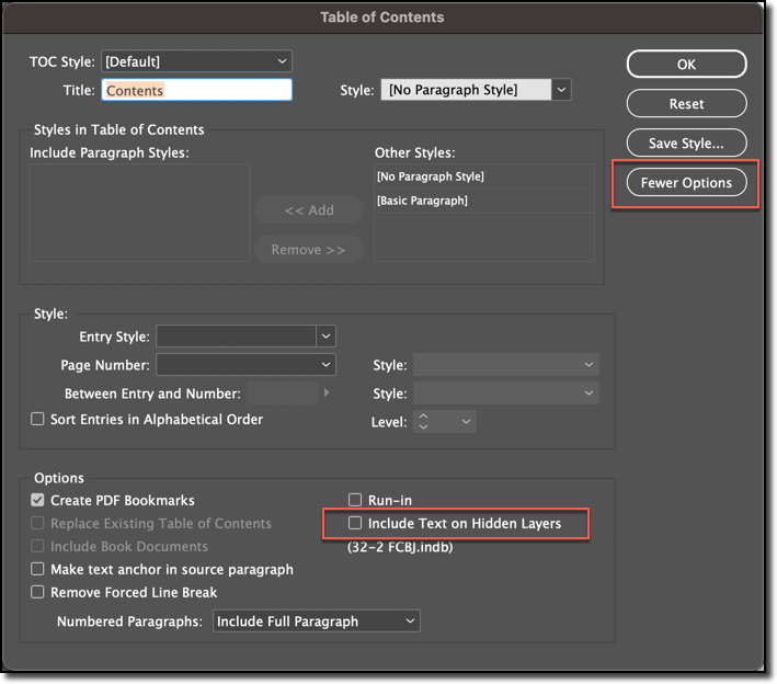

Setting H1 text on a new hidden layer, so that ToC does not show it when show hidden layers checkbox is deselected, but the text variable should. But I don't see such an option.
Choose More Options on the far right to expose the TOC additional controls. What happens if you disable include text on hidden layers?

That checkbox currently does not affect the TOC as H1 is a hidden object on a visible layer.
But if we were to place H1 on to a hidden layer and disable that checkbox in the TOC options, then it rightly disappears from the TOC. Meanwhile H1 also disappears from the running header field (footer) because text variables cannot read through hidden layers by default (Did not find an option to change that :/)
