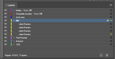

Apr 05, 2025 Apr 05, 2025
With the Parent Page selected, do you see the text frame in the Layers Panel?

Or can you zoom in on this TextFrame - maybe it's locked?
Can you also open Layers panel - and post some screenshots.
OR as you're on Windows - you could use my ID-Tasker tool to get complete structure of the Document - and quickly find this TextFrame.
Community Beginner ,
Hi, it's the only file in this shared OneDirectory. I'll see if I can figure out if the frame is locked. I did also look at layers and made no progress. Thanks!   4R - First proof

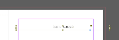

@beno41599860
A potential problem?
(free Browsing part / Doc's structure)
