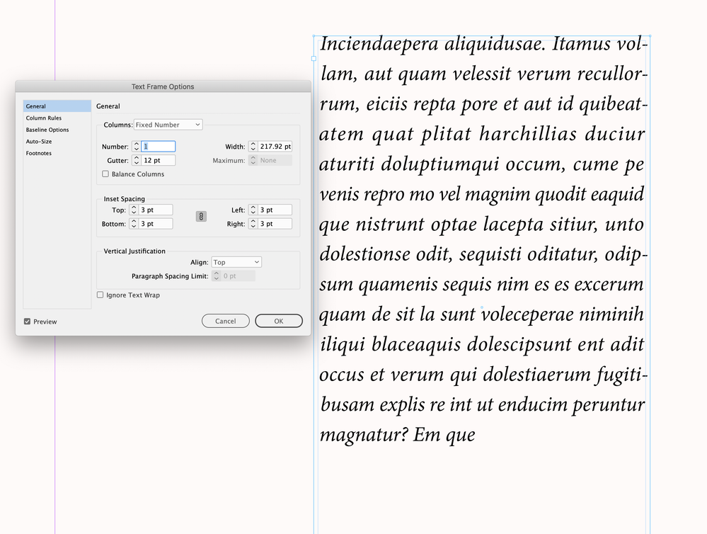

A text frame could have any amount of Inset Spacing applied, which would keep the optical alignment, but prevent any overhang:

InDesign optically aligns the text column to the frame, and to the margin if the frame is aligned to the margin. ID has no hanging punctuation feature, which you might see in other applications—OMA is a better approach because it considers the shape of all the glyphs, and not just the punctuation. I doubt Adobe would ever consider abandoning OMA.
KDP’s safe zone requirement is arbitrary, so an obvious solution might be to simply set a larger safe zone then they require.

But a text frame without a stroke or fill doesn’t print. Consider this case where I’m setting 24pt justified Garamond  on a 100pt margin with OMA turned on. The text visually aligns to the 100pt margins—the puncuation has to sit outside of the frame in order to create the appearance of an alignment.
I could turn off OMA, or add a 5pt inset to force the puncuation inside of the frame, but now the alignment no longer appears to be on my 100pt margin—the optical text margin is at 105 pt:

You can turn off OMA, but then the puncuation no longer hangs creating empty white space around the glyphs:

    for (var i = textFrames.length - 1, frame, scale; i >= 0; i--) {
        frame = textFrames[i];
        frame.textFramePreferences.insetSpacing = [
            frame.textFramePreferences.insetSpacing[0],
            frame.textFramePreferences.insetSpacing[1] + overLeft,
            frame.textFramePreferences.insetSpacing[2],
            frame.textFramePreferences.insetSpacing[3] + overRight
        // quick and dirty solution:
        // horizontal scale text to fit
        scale = (bounds[3] - bounds[1] - overLeft - overRight) / (bounds[3] - bounds[1]);
        frame.textStyleRanges.everyItem().horizontalScale *= scale;
app.doScript(main, ScriptLanguage.JAVASCRIPT, undefined, UndoModes.ENTIRE_SCRIPT, 'Fix Protruding Story');

> text is still outside the text frame. Doens't matter how it's dressed up.
@Eugene Tyson it occurs to me that this might just be a UI issue:
I like that the basis for the text's margin (eg. an optical margin) aligns with the text frame UI's edge, because I want to position the notional (optimal?) margin, precisely.
By contrast, you want to position the text's extreme boundary of all glyphs in the story, so the text frame's UI's edges should represent this extreme boundary. I don't want this because it would make it harder for me to precisely specify where I wanted the margin to be, and I want glyphs to protrude where appropriate.
That might be a good way of stating this if you file a feature request. Not sure. Communication is hard.
EDIT: How about a preference drop down menu "Text frame UI shows:"
1. "Text margins"
2. "Glyph boundaries"
(assuming the technical challenges I mentioned in other post were solved).
