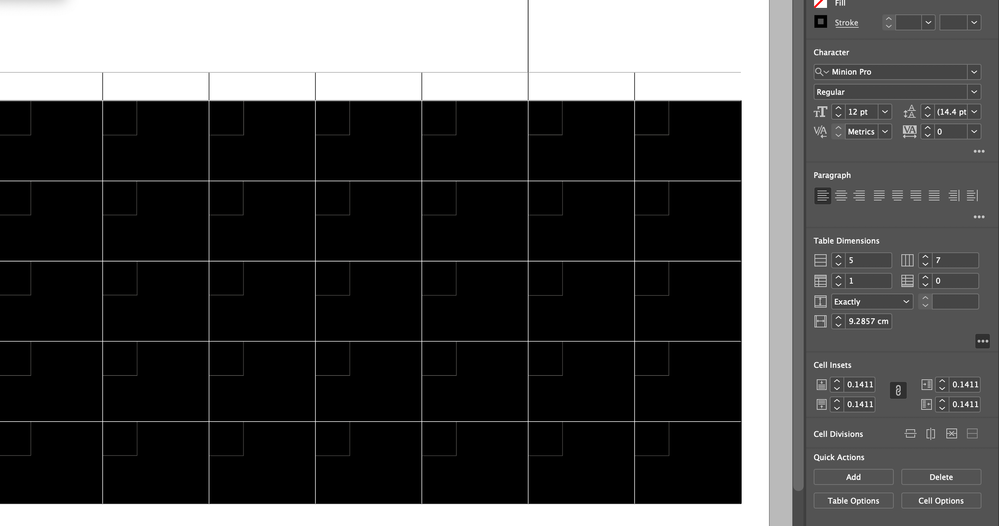

I've highlighted the cells but no proxy showed up...screenshot attachedScreen Shot 2020-07-08 at 10.12.48 am.png

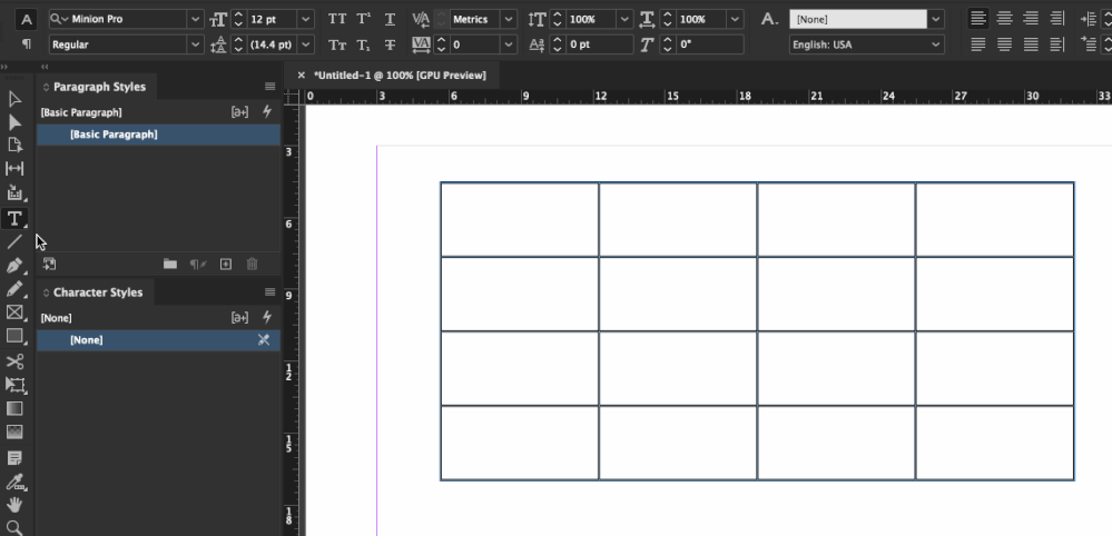

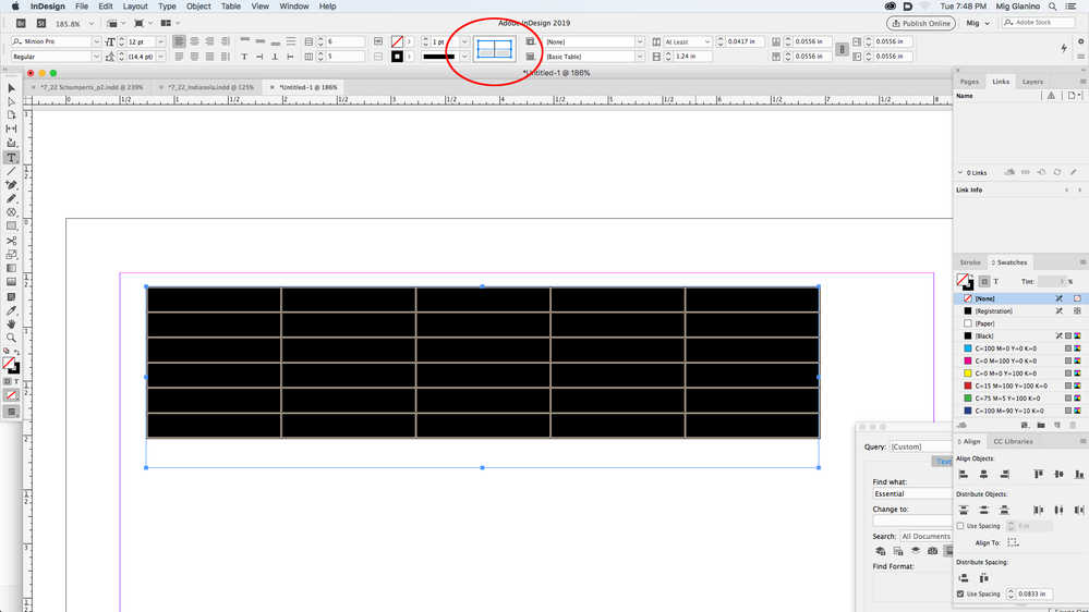

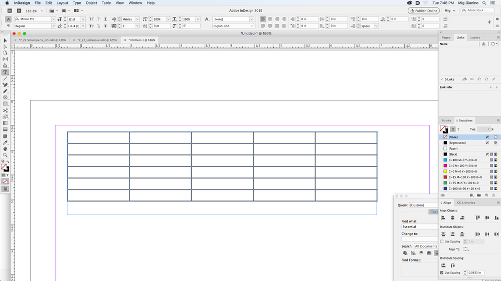

It will show in the Control window that is usually parked at the top of the screen. If you don't see it, go to Window>Control. Here's the table without a selection:
And here's how the Control window looks when the table cells are selected. Notice the red circle.

Well one step closer to success, but still not there. I opened the control window and followed the explanation but the left line was still there once I greyed out the lines I wanted to keep. Am I supposed to apply the changes somehow? After I'm greying out the areas I want to keep, I'm pressing the move tool to see if the changes have applied because that's the only button thats working (I tried return and esc). Am I missing something obvious?

The lines in the proxy that are blue are the lines that will change in the selected cells. You can change things like the stroke width, stroke color or stroke style. The field to the left of the proxy that reads 0 pt is the stroke width (thickness of the lines). The line that sticks up is unchanged because the center line in the proxy is not selected (blue).

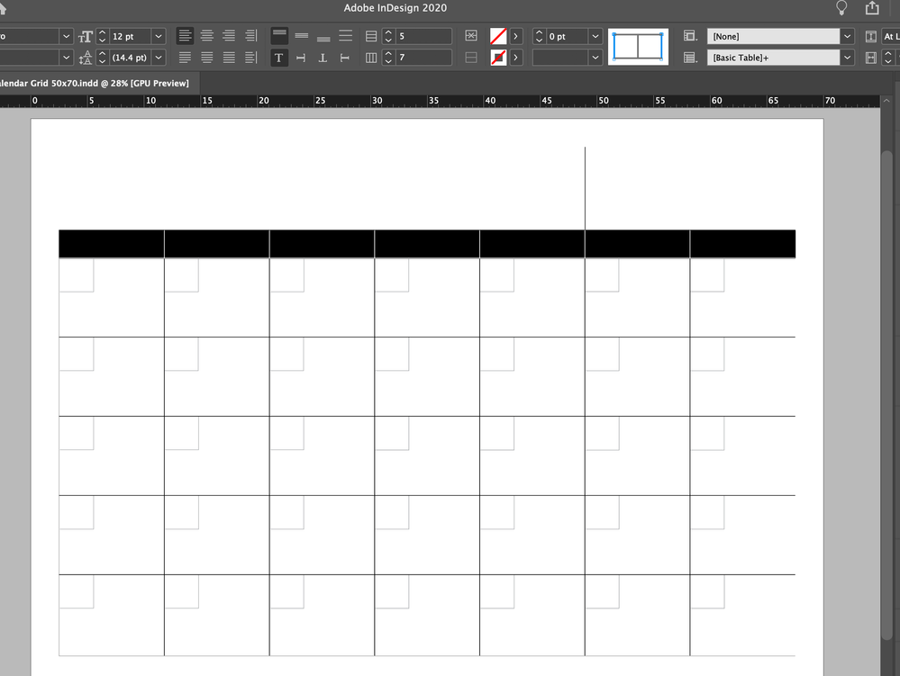

I've tried doing it vertically also but have had no luck

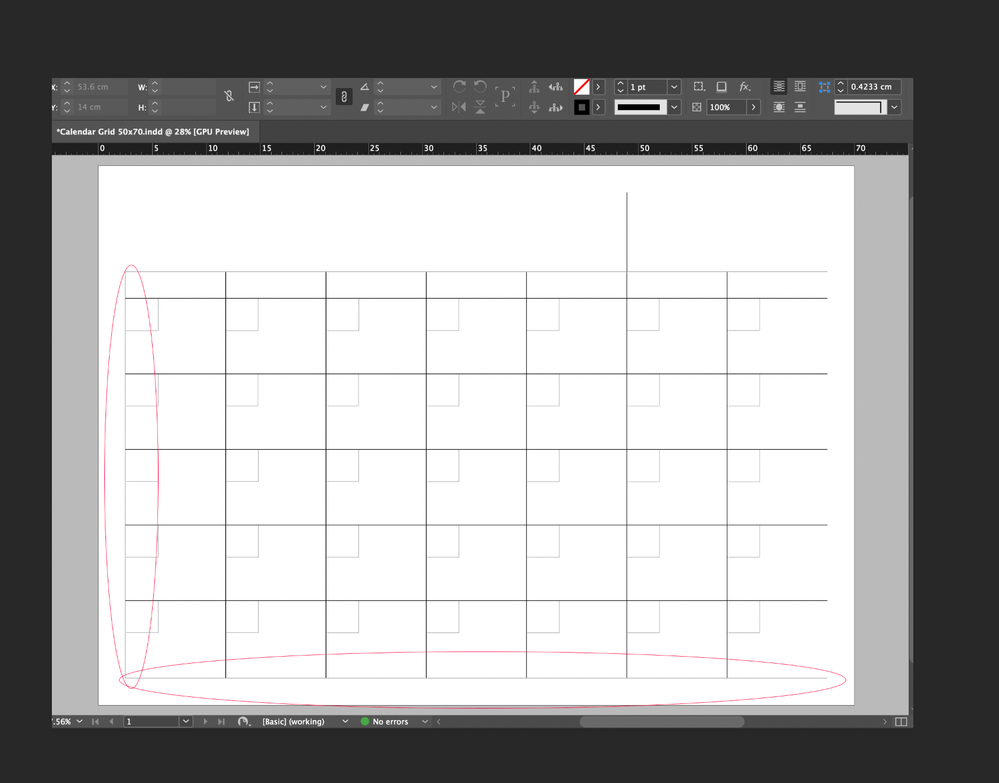

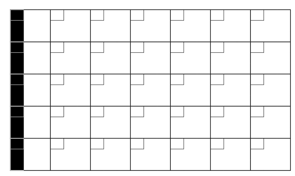

I want to delete the lines in the red ellipse. Just the table border line on the left side...not the little squares

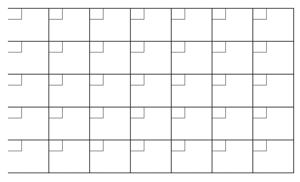

By the looks of it, you're starting with this:

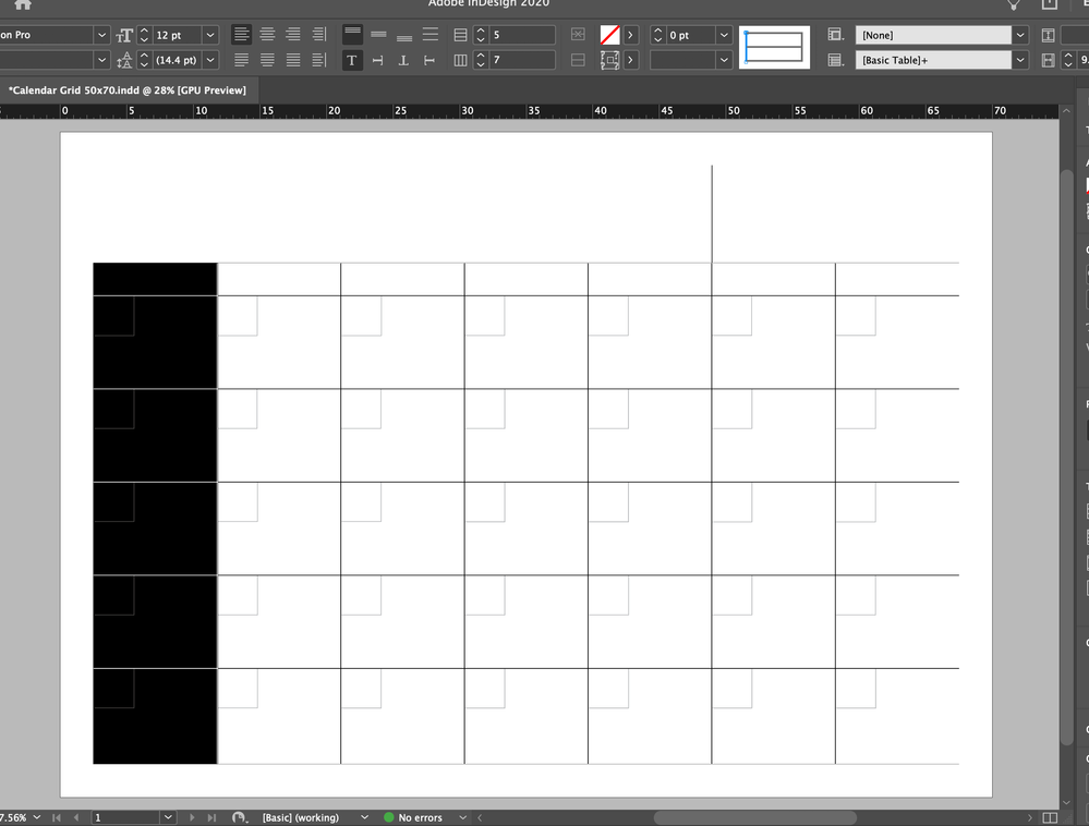

Select the first column like this:
…and select only the left-most line in the proxy. If you set the stroke weight to zero, it will look like this:

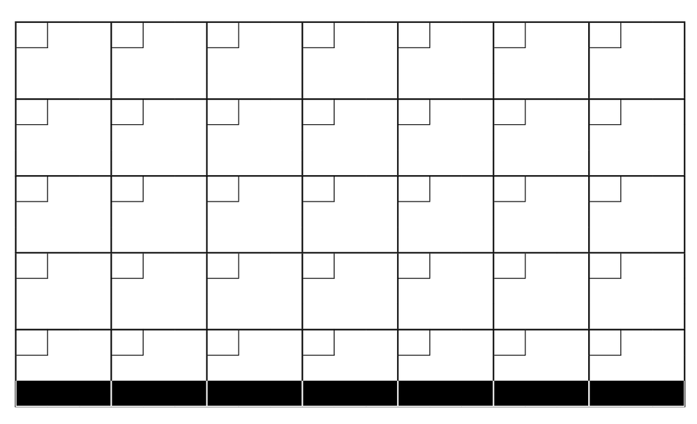

If that's what you want, you can delete the lowest line by selecting the bottom row like this:
Set the proxy on only the bottom line and do as above. Is that what you're after?
