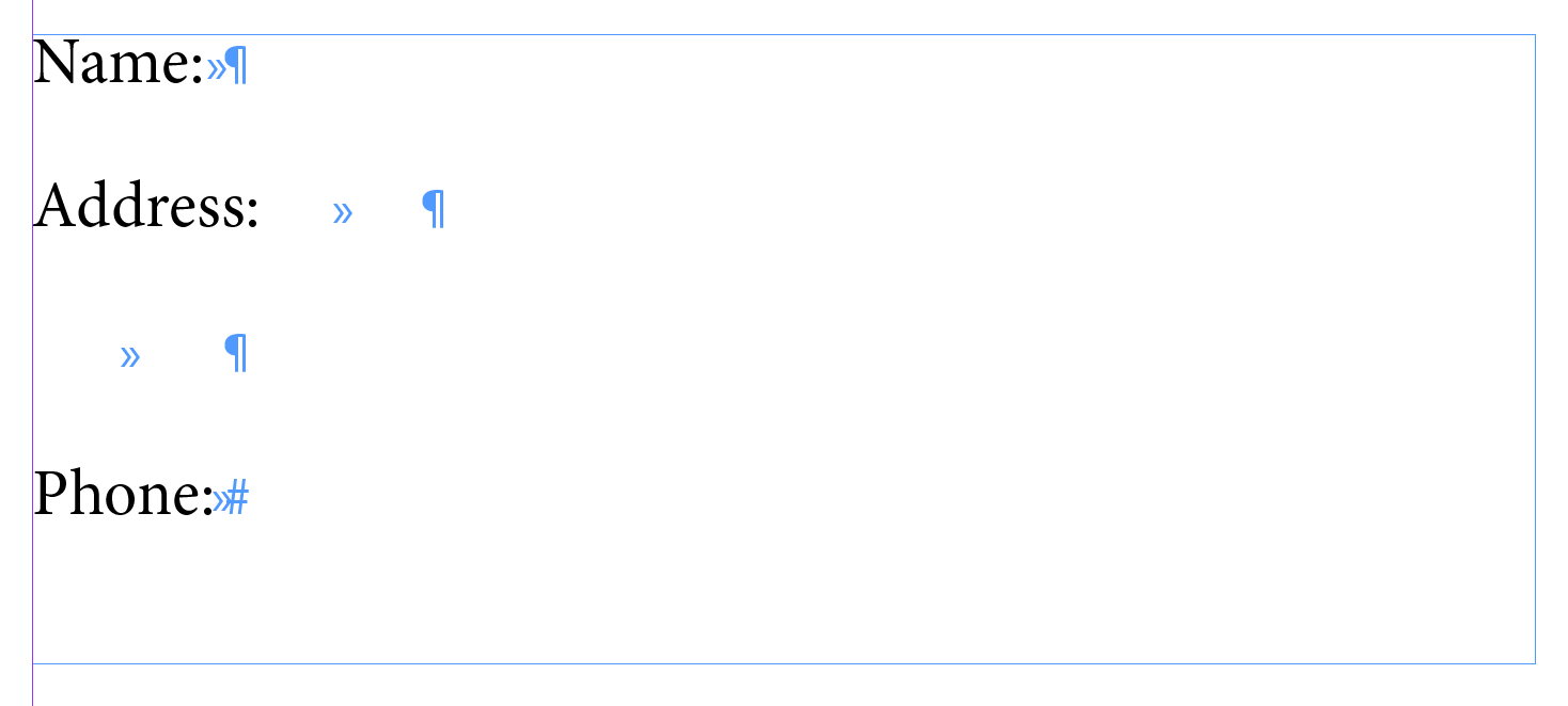

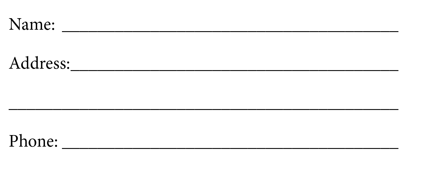

I prefer to define an underline as a leader character with a right-align tab. Sometimes it appears that there are spaces between the lines in InDesign, but they don't print that way.

Screen Shot 2019-04-01 at 3.08.38 PM.pngScreen Shot 2019-04-01 at 3.09.02 PM.pngScreen Shot 2019-04-01 at 3.09.16 PM.png

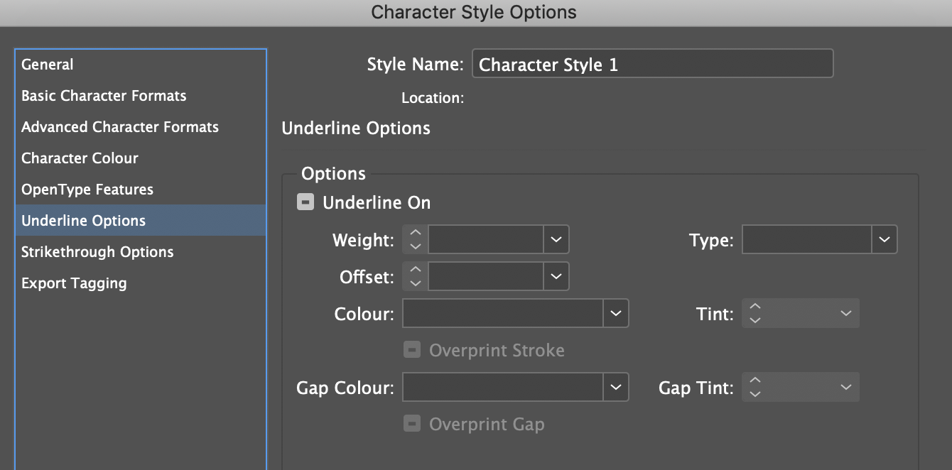

Create a Paragraph or Character Style (as appropriate) and use the underline feature.

In this case, create the underline style and apply it to the tab, or set the tab leader to underline.

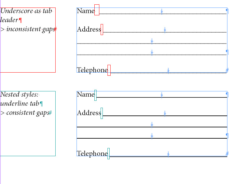

Guide ,
Apr 01, 2019 Apr 01, 2019
Awitmer  wrote
Has anybody every seen the spaces between lines in the final printed output? I have already.
If you are using the underscore glyph as a fill character in a tab, you could get spaces between if you have applied tracking or kerning. The bottom image has a tracking setting of 10, while the top one has none.
Maybe not the cause of your issue, but a possibility.

Apr 02, 2019 Apr 02, 2019
Hi.
Although I'd also definitely reject the idea of using line tool, I have to disagree with my esteemed colleagues:
I would vote for a character style applied to tabs.
Either using nested or grep styles - depends on your layout really...
