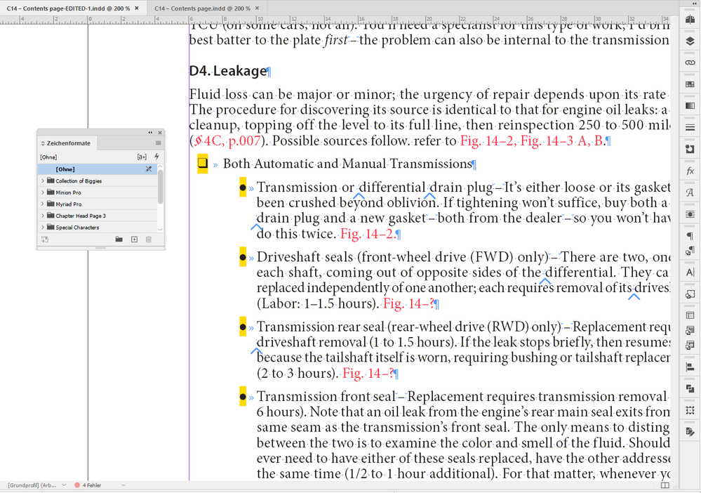

I'm attempting to resurrect a few old Quark files that I imported into InDesign decades ago (ID 1or 2). I've dealt with a myriad of problems so far but one just won't go away – weird substitutions for tabs in Minion Pro (an encircled 9), scissors and some other thing in Myriad Pro (in the green chapter blocks). See attached file. I'm trying to believe that just turning off hidden characters will suffice, but I fear that I know better. I ran the old ID files through IDML, then reopened them in ID 2022. Doing so eliminated the problem in one chapter but had no effect on the others. Thoughts? Suggestions? A fix? Thanks for any help you might offer.

As far as hidden characters, I'm not seeing anything unusual. There are Index Markers throughout (as indicated in green on my grab attached), and the glyphs for your Altemus Dingbats are missing (since I don't have the font) and may need to be remapped anyway if you used old Type 1 before and are using an OTF font now, but that would be a simple search and replace.
Can you show a screen grab of what YOU are seeing?

would be good to see a screenshot of your issue. I downloaded and opened both of your InDesign documents with InDesign 2022. Cannot see any issues with the tabs or "space between words".
In one of my tests I substituted the missing font Altemus Dingbats with an old Type 1 version of Zapf Dingbats for Windows. The applied character style of the text where the missing font is used is named "Zapf Block", maybe a hint to Zapf Dingbats in your old QuarkXPress files?
Page 187 without font substitution:
Substituted to Zapf Dingbats Type 1:
Nothing really weird, I think…
Tested with my German InDesign 2022 version 17.2.1.105 on Windows 10.

If you think, that the entries for the Index are weird, that are special characters that represent Index markers.
Brad already pointed this out! Open InDesign's Index panel and see into the entries there:

Zooming in on the OP's original screen shot, there are shaded arrows between every word — instead of the normal blue dot to represent a spacebar.
Enargement of OP's screen capture: wrong glyph is used for blue dot/spacebar.
@– Pem –, I think this cruddy encoding is going to cause some problems for you, either as you attempt to adjust the layout or when you export a PDF for press. And if you're making an accessible PDF, definitely these spacebars will not be recognized by assistive technologies and the PDF might not be able to be read at all, or will be read as one ginormous word. Gah!
