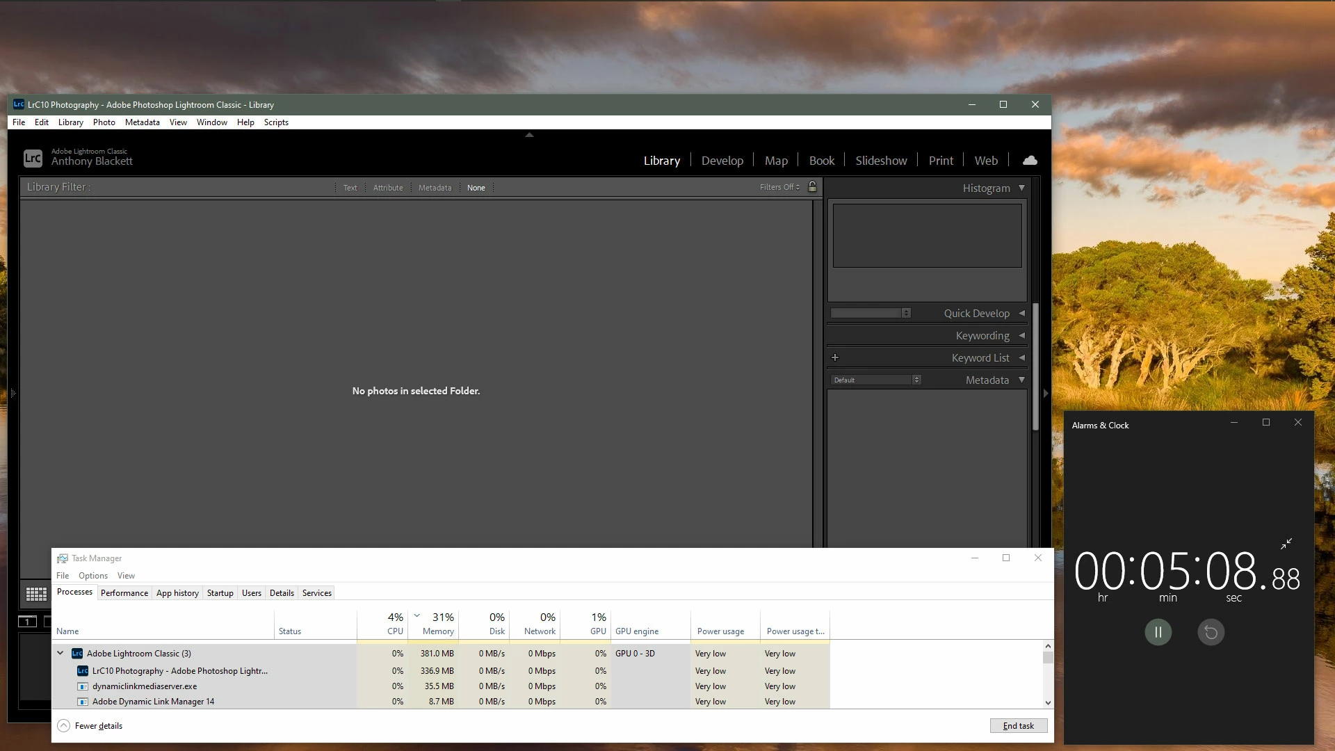

Starting LrC 10.2 in Library Grid view with an empty folder selected, LrC soon settled into an idle state using the small amount of memory shown in the screen shot below taken after 5 minutes of doing nothing.

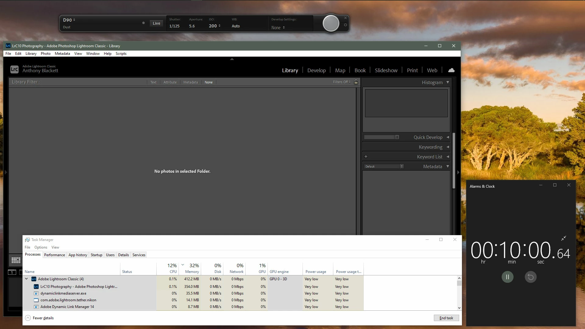

At 7 minutes of running, I activated Tethered Shooting with the Nikon D90 connected. At the 10 minute mark, memory use had increased, as shown in the screen shot below.

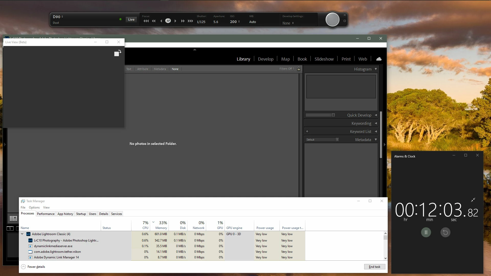

At 12 minutes, I activated Live mode as shown below, where you can see almost 200MB more memory had been taken by LrC in just 2 minutes of Live view.

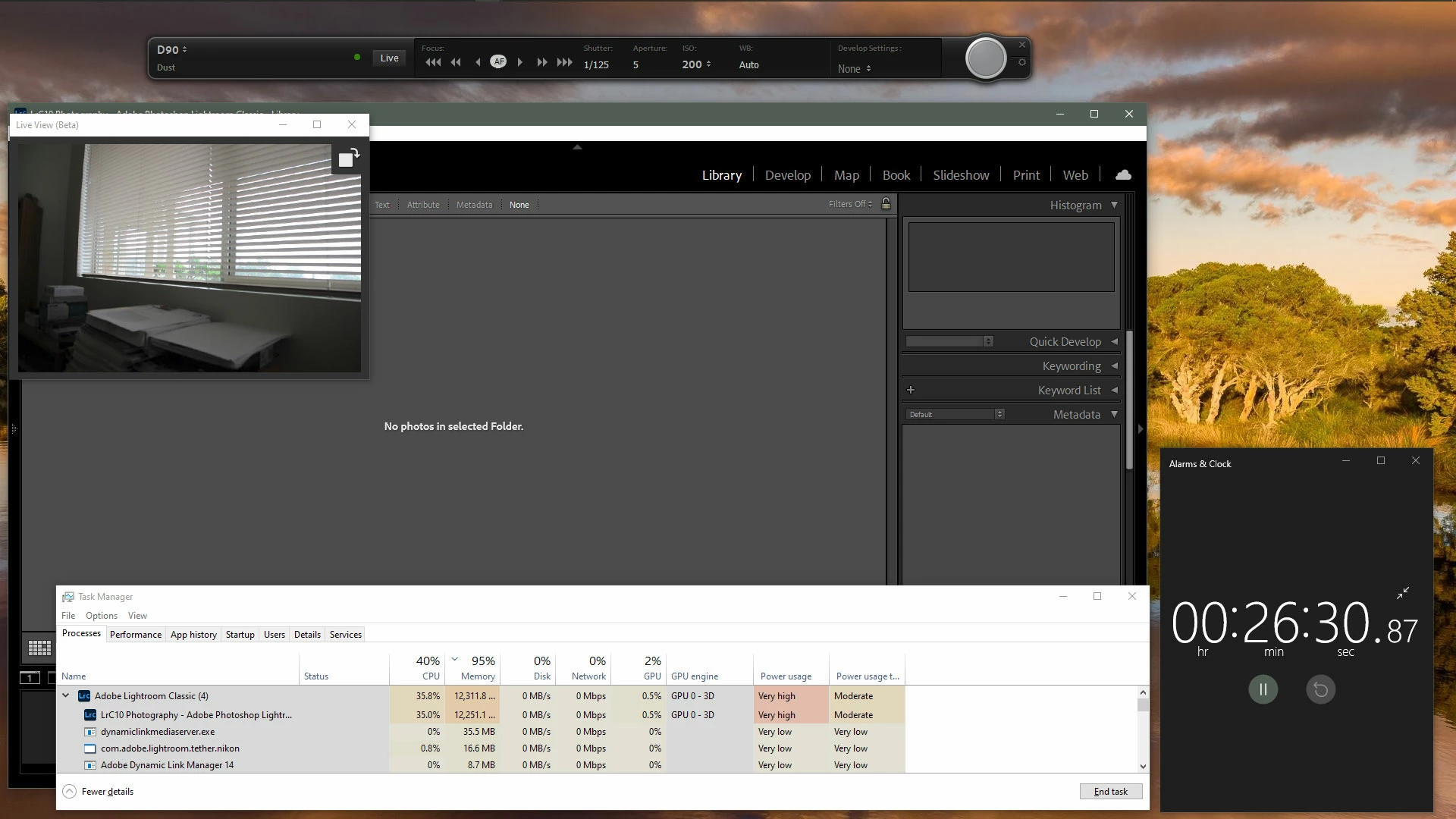

Now things get very bad. Leaving LrC in Live shooting mode while doing nothing else (no exposure settings changed, no shots taken), memory usage rapidly climbed at an astonishing rate, and after 10 minutes had passed, LrC had taken over 10.8GB.

I activated Live shooting again and immediately LrC began its relentless consumption of memory. After another 2.5 minutes it had reached a staggering 12.3 GB, as shown in the screen shot below.

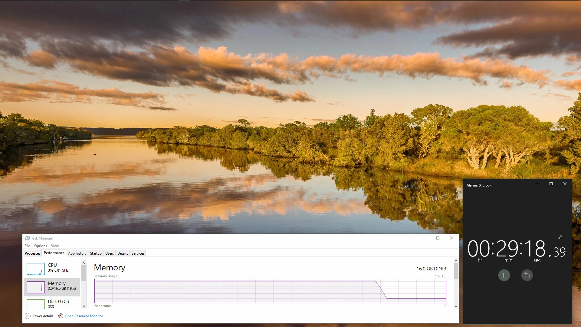

I then closed LrC. The release of its massive memory grab can be seen in this screen shot on Windows Task Manager's memory performance tab.
This test lasted only 29 minutes and during that time LrC took almost all available physical memory in a period of only 12 minutes while Live Tethered Shooting was active.
