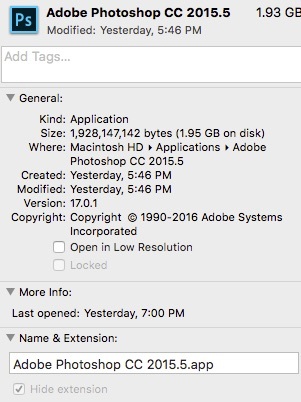

You were right. Thanks for catching that. The thing is I've made the correction and still have the problem. LR System Info now reads,
Config.lua flags:
EditExternally.OverridePhotoshopPath = /Applications/Adobe Photoshop CC 2015.5/Adobe Photoshop CC 2015.5.app
...which is the same as the contents of my Config.lua file
Here is the OS system info about the PS app. As far as I can see, the path I've specified above should be correct, right?
Something strange just happened. I restarted LR (PS was already open), immediately selected one picture and had "Edit in" appear functional. I then selected several items and tried "Edit in" and it was non functional. I then restarted LR, choose one item, "Edit in" appeared functional so I choose it... but nothing happened. PS is running, but the item did not open in it. Going back to LR, "Edit in" is now greyed out!
After some experiments, it seems "Edit in" mostly appears (although it still does not work) with the image that is preselected when LR first opens. After selecting an image "Edit in" goes grey.
